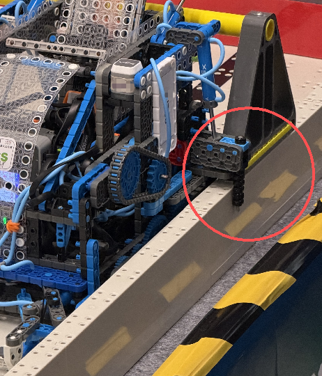

Our Robot is equipped with a mechanism that allows it to hang on / climb onto the top of the Field Perimeter (the outer wall of the Field) and continue operating during a Match, e.g., driving along the wall while not contacting the Floor. See the attached photo, in which the relevant mechanism is highlighted in the red circle.

[Example Image]
