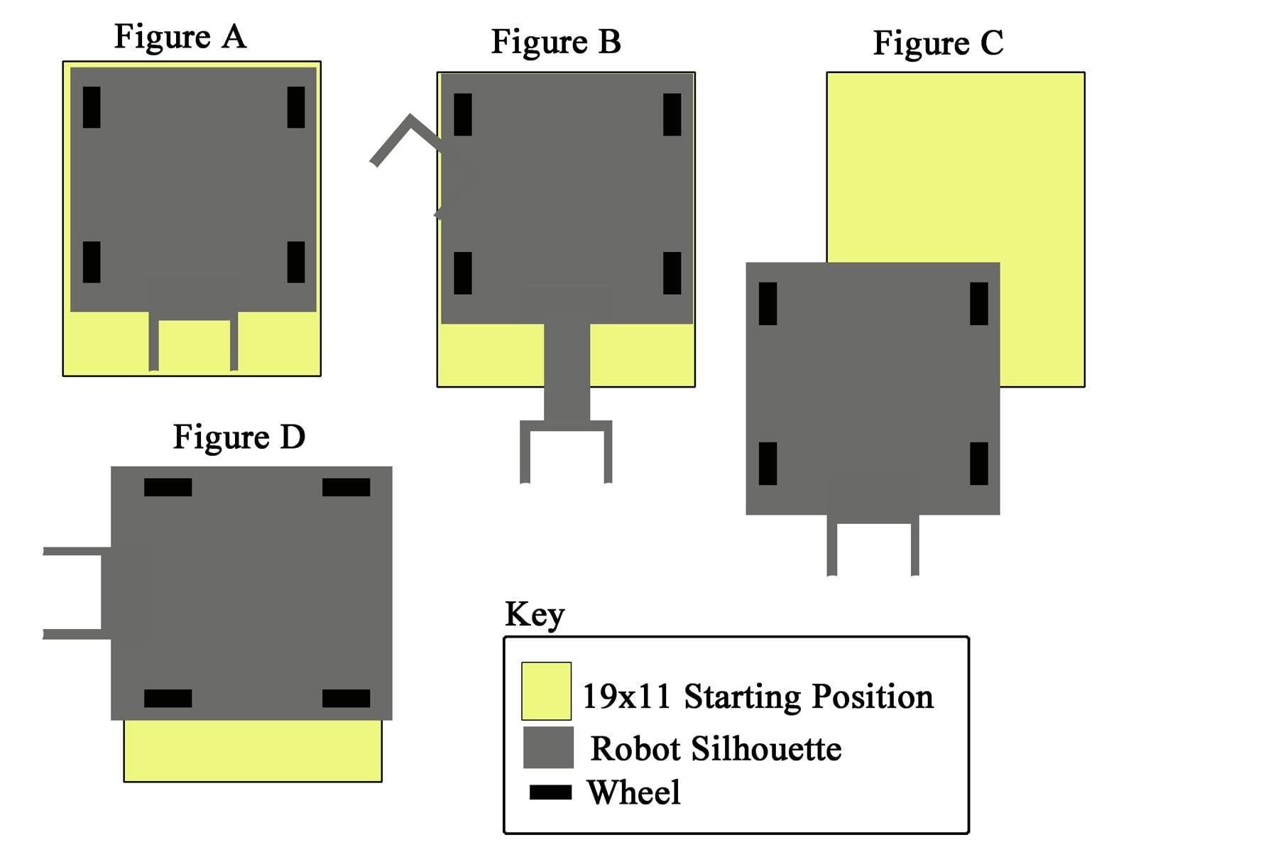

707: <RSC7> RESETTING Robots during a Programming Skills Match (Clarification of G4 Question)
This question was asked and answered, but I need some clarification please.
"G4 839A 2 weeks ago Rule G4 Pre-match setup states that at the beginning of a Match, each Robot must meet the following criteria: 1. Only be contacting the Floor and/or the field perimeter; 2. Fit within an 11” x 19” (279.4mm x 482.6mm) area, bounded by the Starting Positions; 3. Be no taller than 15” from the Floor. Rule R5 restates similar conditions. Rule RSC1 states standard rules apply in most cases. All rules and scoring from previous sections apply to the Skills Matches, unless otherwise specified.
Our understanding of these rules are that the robot must fit within the dimensions specified above at the start of each match in one of the 2 designated starting positions. There are no other rules that states otherwise for autonomous skills matches. However, we were asked to change our autonomous skills routine during our last competition by one of the judges as they stated the robot must fit within the starting dimensions every time we launch a new routine in the starting area. Please clarify if we correctly interpreted that the starting dimensions applies to only the first launch at the beginning of an autonomous skills run or if it in fact applies to all subsequent launches in the starting position.
Answered by Game Design Committee Our understanding of these rules are that the robot must fit within the dimensions specified above at the start of each match in one of the 2 designated starting positions. There are no other rules that states otherwise for autonomous skills matches.
This interpretation is correct.
<RSC7> Handling Robots during a Programming Skills Match. A Team may handle their Robot as many times as desired during a Programming Skills Match. a. Upon handling the Robot, it must be immediately brought back to any legal Starting Position. i. Drivers may reset or adjust the Robot as desired from this position, including pressing buttons on the Robot Brain or activating sensors.
My clarification question; When a team returns their robot to a starting position during a programming skills run, do they have to return it to the 19X11X15 size every time they reset the robot? Or do they have to just have it be the 9X11X15 size the first time they are in the starting position at the start of the match? If they do not have to return to the 19X11X15 size, are all of these positions (A-D, see image) legal when resetting the robot during a robot skills match?
![[Example Image]](https://events.vex.com/storage/markdown/uploads/XBp4rHM0dzwcFQnnqr0wXyJOvxDvolEeqJDijEKb.jpeg)
Respondido por committee
The definition of Starting Position reads as follows:
Starting Positions – The two (2) designated 11” x 19” (279.4mm x 482.6mm) volumes of the Field where Robots must start the Match. Starting Positions are bounded by the inner edges of the long black lines, outer edge of the short black line, and the inner edge of the field perimeter. See Figure 2 for more details.
RSC7 states that Robots must be brought back to a Starting Position (i.e. the 11"x19" volume where the Robot started the Match). The requirement for a Robot to be completely confined within this volume (i.e. rule G4) only apply during pre-Match setup, as noted in Note 2 of G4.
Therefore, all four hypothetical scenarios in your attached image would be considered legal RSC7 repositioning. With that being said, we would advise Teams to err closer to the side of Figures A, B, and D, in the interest of making it abundantly clear to the Head Referee that you have returned to the Starting Position.

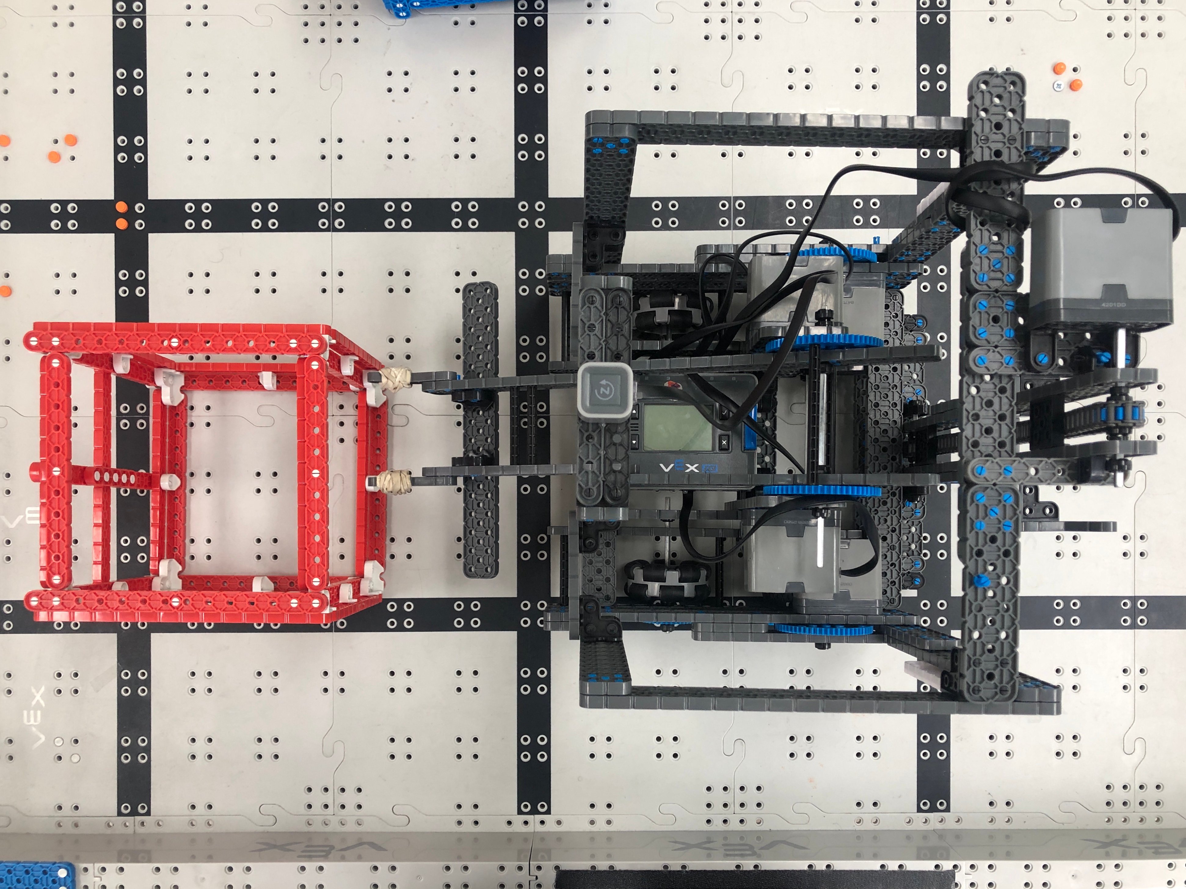

588: Is This Starting Position Legal?
I have a question about the starting position in the VEX IQ skill challenge.
During the program skill challenge, If my robot start in the position below, is it legal? The driving base is within the starting position, the arm is longer, but not touching the the cube.
![[Example Image]](https://events.vex.com/storage/markdown/uploads/c9poZmdTLElgInSuIe4C16opvR00YN9zmUAbNY1x.jpeg)
Thank you for providing an image to help clarify your question. However, please review the Q&A Usage Guidelines, specifically point 3, "Quote the applicable rule from the latest version of the manual in your question.". The definition of Starting Position, and rule G4, are quoted as follows:
Starting Position - The two (2) designated 11” x 19” (279mm x 482.6mm) spots on the field where Robots must start the Match. Starting Positions are bounded by the inner edges of the long black lines, outer edge of the short black line, and the inner edge of the field perimeter. See Figure 2 for more details.
<G4> Pre-match setup. At the beginning of a Match, each Robot must meet the following criteria: a. Only be contacting the Floor and/or Field Perimeter. **b. Fit within an 11” x 19” (279.4mm x 482.6mm) area, bounded by the Starting Position. ** c. Be no taller than 15” from the Floor.
The Robot in the photo you have referenced extends past the inner edges of the long black lines in the Starting Position, and would therefore not be legal.
One "thought experiment" to help determine if a Robot is within the Starting Position would be to imagine a spotlight shining down on the Robot - if its shadow would fall within the Starting Position, then it is legal. This similar Q&A provides another test that Head Referees can perform before a Match:
for a Robot which pushes the limit of allowable size, a measuring tool could be as simple as sliding a VEX IQ beam or plate along the edges of the Starting Position. (the crossbar of the VEX IQ Challenge Sizing Tool, turned vertically, could also be used)
This answer is the same for Teamwork Challenge, Driving Skills Challenge, and Programming Skills Challenge Matches.
