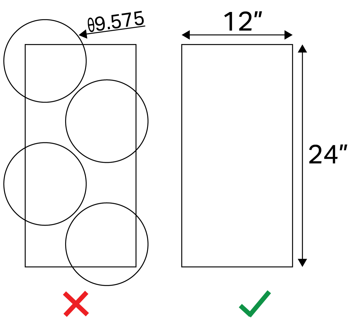

A limited amount of custom plastic is allowed. Robots may use custom-made parts cut from certain types of non-shattering plastic. It must be possible to have cut all of the plastic parts on the Robot from a single 12” x 24” sheet, up to 0.070” thick.
  • The intent of the area/thickness constraints is to limit the number of custom plastic parts used in Robot construction, not to define an absolute volume. For example, using a sheet which is 0.035” thick does not permit two 12” x 24” sheets’ worth of parts.
  • Plastic parts do not have to be literally cut from the same original 12” x 24” sheet. However, all individual parts must be able to “nest” or rearrange into a 12” x 24” area. A collection of parts which theoretically have a total surface area of 288 square inches, but cannot be nested onto a single 12” x 24” sheet, would not be legal. See Figure R19-1.

  • Note: The phrase “as cut from a single 12” x 24” sheet” is intended to mean that all individual plastic pieces must be able to theoretically “nest” or rearrange into a 12” x 24” area. The plastic pieces do not have to be cut from the same original 12” x 24” sheet. Teams are encouraged to “map” plastic use on a 12” x 24” sheet of paper for reference at tournament inspection.
    Figure R19-1: Custom plastic parts must fit within a single 12” x 24” sheet of plastic.
