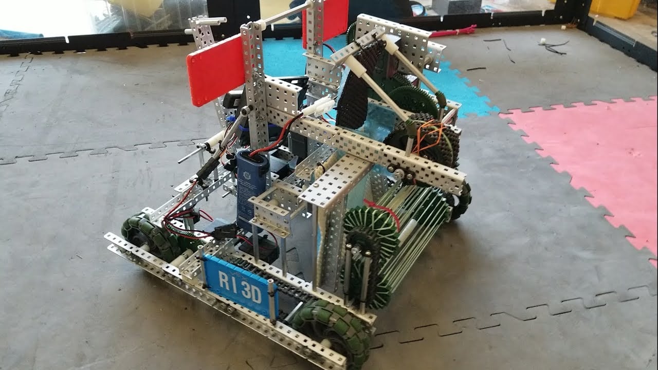

Many of this year's robots have a ball intake like a paddle wheel wrapped in rubber bands or elastic (like the attached picture). The rubber bands often get entangled in other robots. How should a referee handle a match when the outcome is dependent on an entanglement? As reference the game manual defines entanglement as:

"Unnecessary" is the key word here. There has been no precedent for robots with this type of intake failing inspection (that I know of), and I wouldn't expect that to change now, but I'll still ask. Is this type of intake legal?
Yes, the intake in the attached photo appears to be legal, in the context of this question regarding Entanglement hazards (i.e. we can't see if there are any 3D printed parts, or check if the rubber bands are of legal width, etc). The intent of <R3c> is to prohibit mechanisms which serve no primary purpose other than Entangling opponents (e.g. a net).
