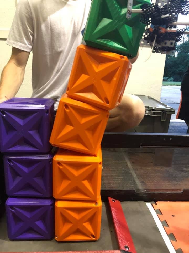

We have begun to see a number of interesting scoring situations, and are looking for clarification regarding the current game rules. How many of the cubes in the match photo below are scored?
There appears to be two Base Cubes and at least six cubes which meet the definition of a Stacked Cube. A seventh cube may also be a Stacked Cube under the definitions below.
Note, too, that a robot it touching the Green Cube, so that one is not scored.
Can you provide clarification of the rules and indicate how many Cubes the game designers would have intended to meet the definition of Stacked?
Your analysis is correct - all Cubes in the photo would be considered Scored except for the green one.
