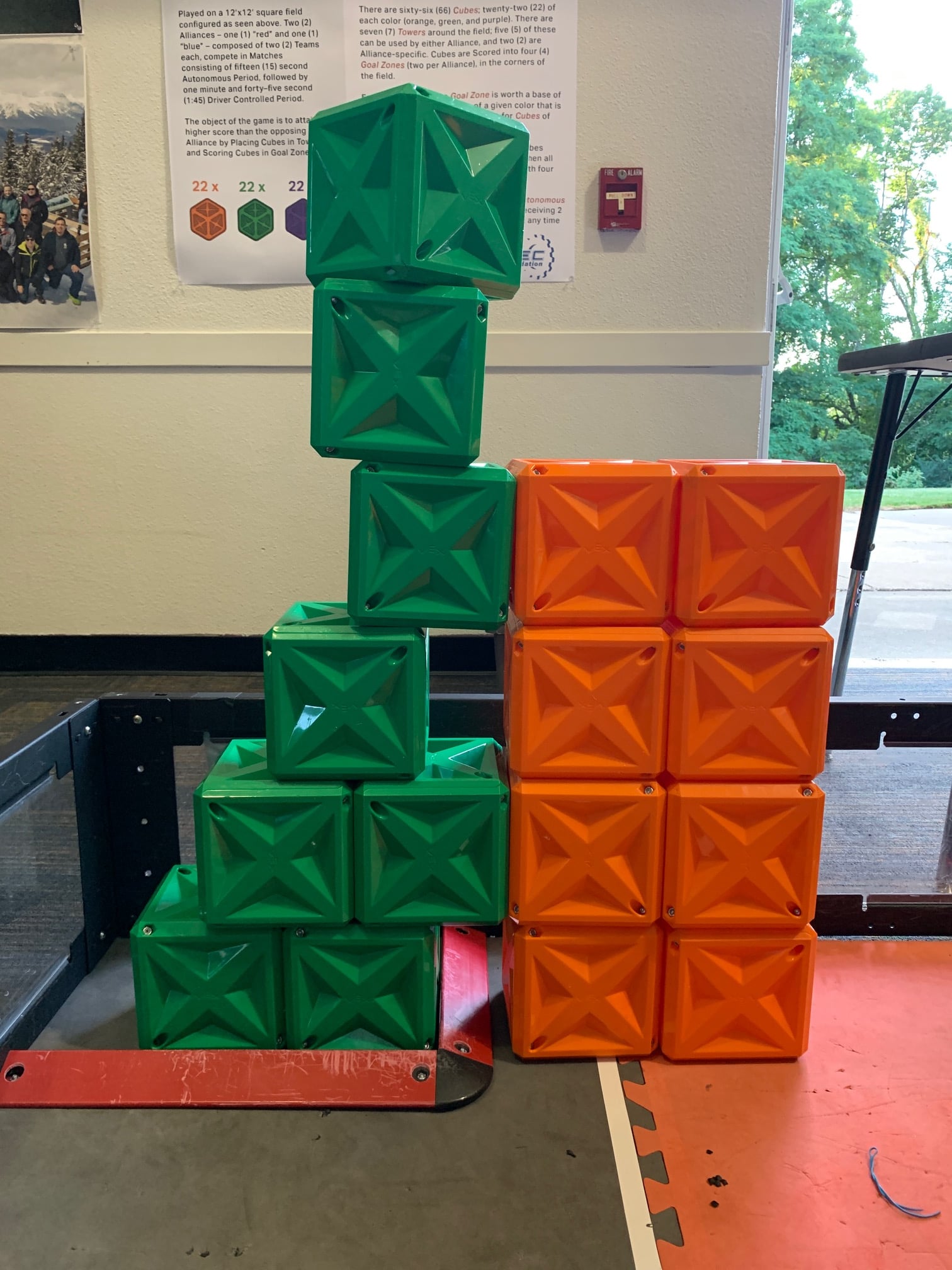

Here's an interesting scoring question.
In the photo below, there are clearly two Base Cubes. Based on the definitions in the current game documentation, it appears there may be six Stacked Cubes. All the Green Cubes on the Base Cubes seem to meet the definition of Stacked Cubes.
Can you verify which cubes score?
The following definitions are found on Page 10 of the Tower Takeover, in Game Definitions Scored - A Cube status. A Cube is considered Scored in a Goal Zone at the end of a Match if it is not contacting a Robot of the same Alliance color as the Goal Zone, and meets the criteria of being either a Base Cube or a Stacked Cube.
Base Cube - A Cube status. A Cube is considered a Base Cube if it meets the following criteria at the end of the Match:
  1. Contacting the gray foam tile within a Goal Zone.
  2. Level or “flush” with the gray foam tile.
Stacked Cube - A Cube status. A Cube is considered a Stacked Cube if it meets the following criteria at the end of the Match:
  1. Contacting the Top Surface of a Base Cube or Stacked Cube.
  2. Not contacting the top of the field perimeter wall.
  3. Not contacting the Top Surface of any Cubes which are not Scored
[Example Image]
Answered by Game Design Committee
Your interpretation is correct. All green Cubes in the photo would be considered Scored.
