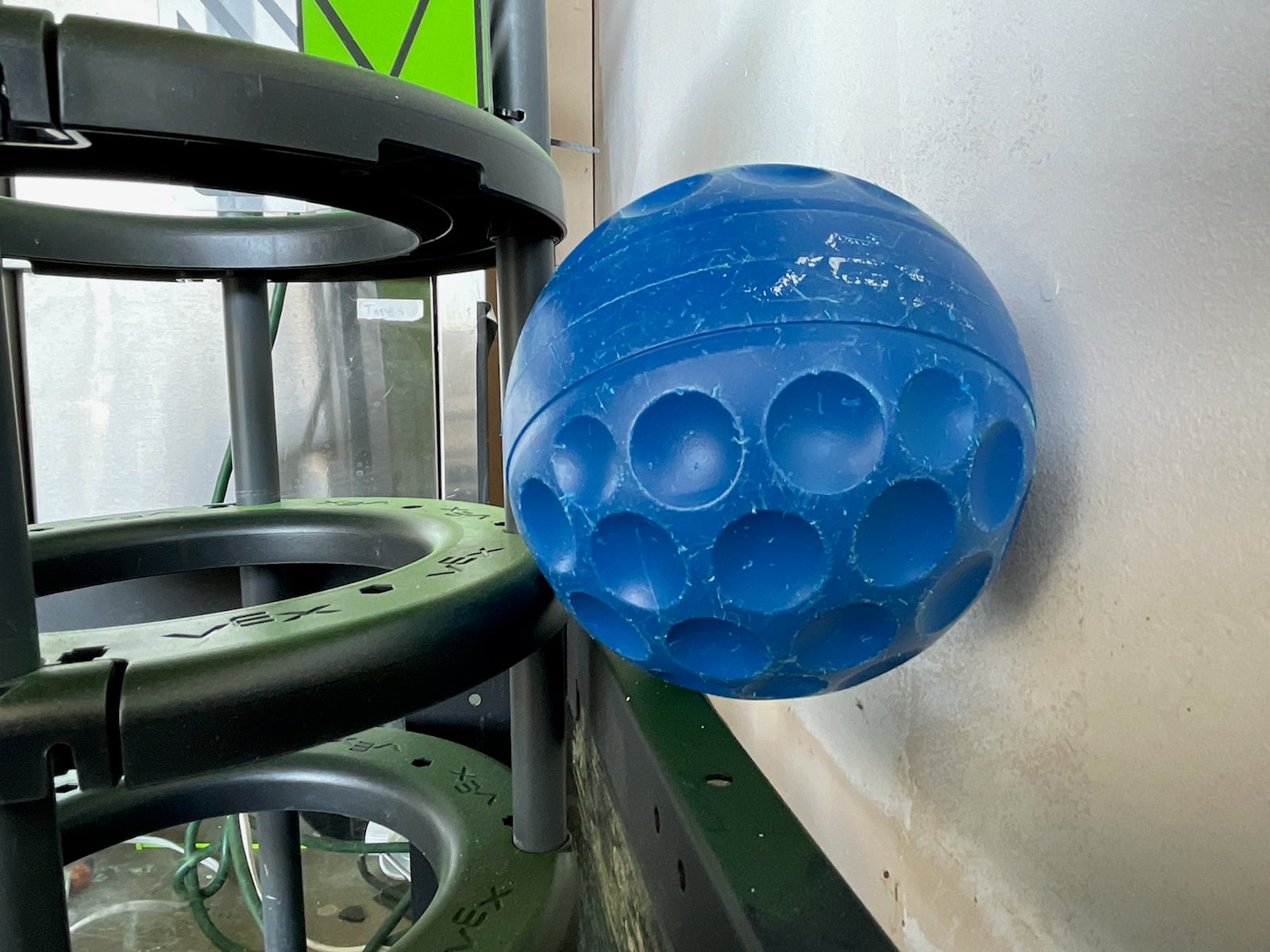

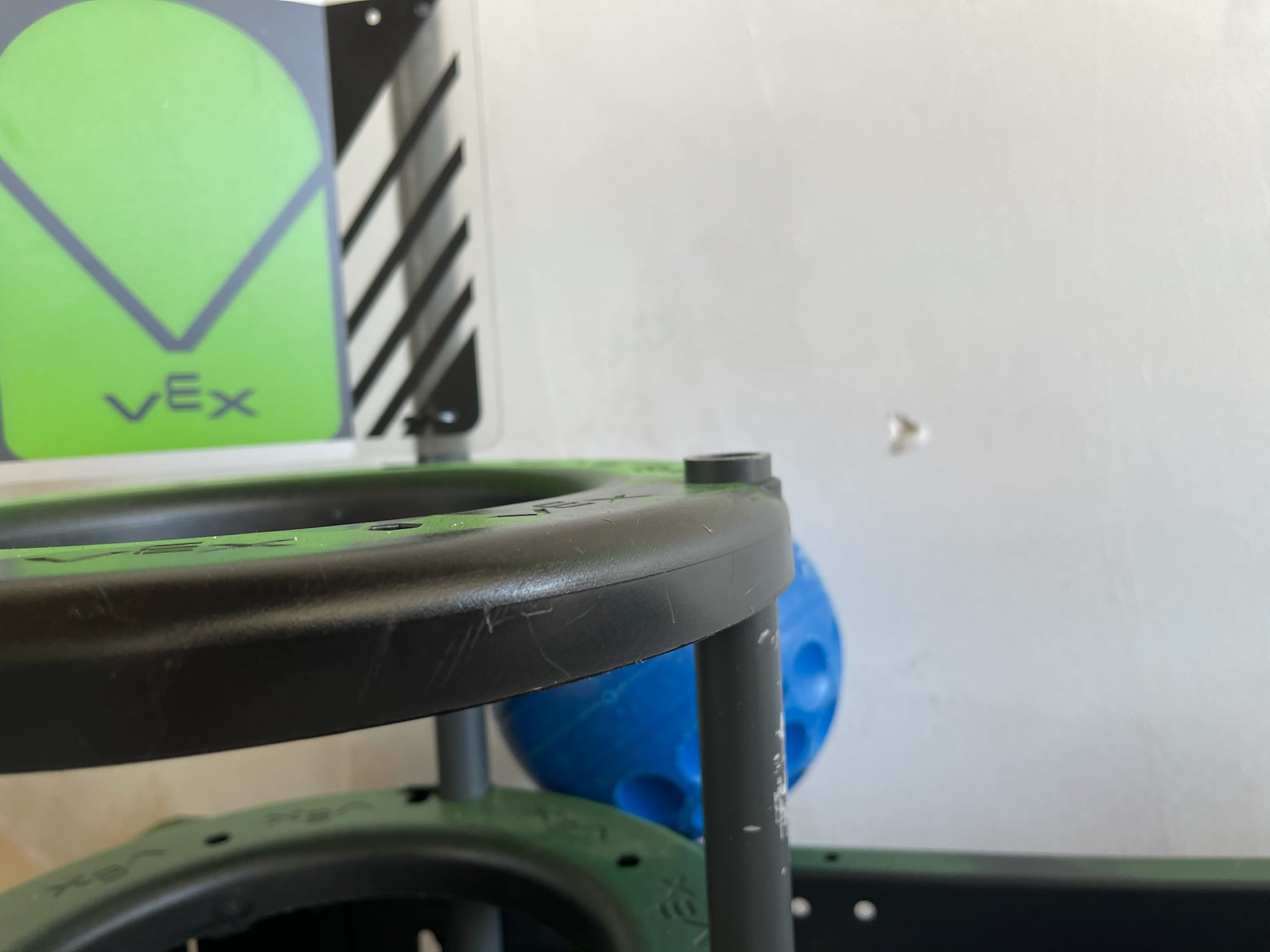

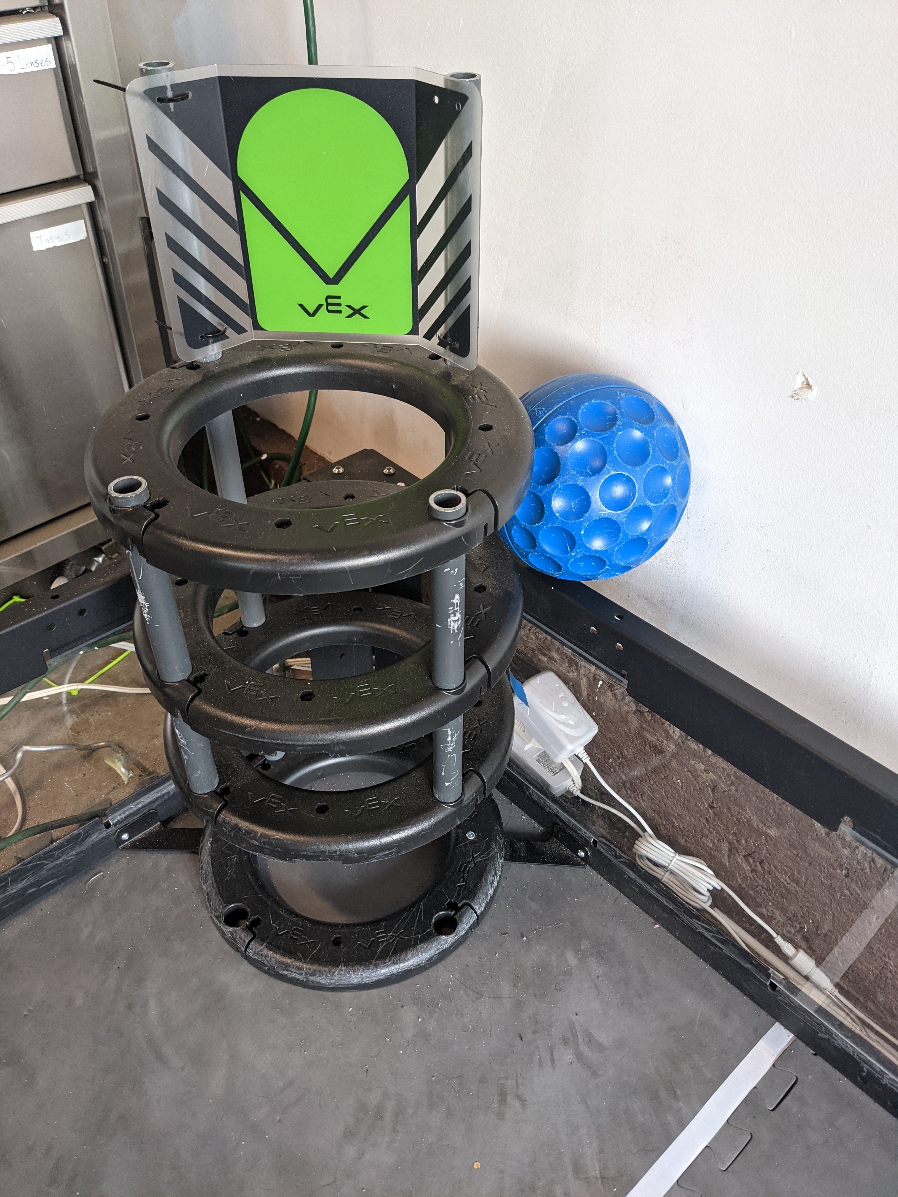

A student asked if this ball was scored, and I could not give an answer. With more teams this year putting fields in rooms that hardly fit them, this is happening more and more frequently.

The image attached meets the definition of Scored due to Q&A 690, meets the modified definition of Scored in LRT9, and follows Q&A 731. SG6 determines if this ball is scored.

[Example Image] [Example Image] [Example Image]

If a Ball is on its way out of the Field (as determined by the Head Referee), but is deflected back into the field by a Driver, field monitor, ceiling/wall, or other external factor, <SG6> would apply. This Ball should be considered “out of the field” and removed by the Head Referee. If the redirection occurred due to contact with a Driver, it will be at the Head Referee’s discretion whether <SG6> or <G9> should apply.
Therefore, the Ball in your attached images would be considered "out of the Field", and would not be considered Scored.
