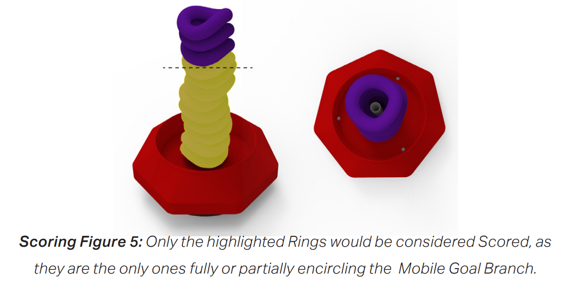

On page 18 of the game manual near the bottom Scoring figure 5 is shown, which depicts a stack of rings on a mobile goal that exceeds the height of the branch, resulting in the top few rings not being scored (I have attached this image to this Q&A) [Example Image] The caption for this figure reads:
Only the highlighted Rings would be considered Scored, as they are the only ones fully or partially encircling the Mobile Goal Branch.
From my understanding of Note 1 bullet point 3, none of the rings in Figure 5 should be considered scored, since the rings on top which are not considered scored are contacting the rings beneath them, causing a chain of not scored rings which results in all of the rings not being scored. A very similar situation is show in in Figure 3 and Figure 2 that demonstrates this concept. Despite this, Figure 5 states that the rings below the unscored rings are, in fact, scored, which seems to be a contradiction. Can the GDC please clarify if the green shaded rings in Figure 5 are not scored as the Note states they are not or if they are scored as the caption say they are? Thank you.

The intent of the figure was primarily to demonstrate what was meant by "encircling a Mobile Goal Branch", by depicting a scenario where Rings did not meet this definition.
Your interpretation of Note 1 is correct; if this situation were to actually occur in a Match, none of the Rings would receive points, as they are all transitively contacting the top un-shaded Rings. We will be sure to update this caption in a future Game Manual update to make this distinction more clear.
