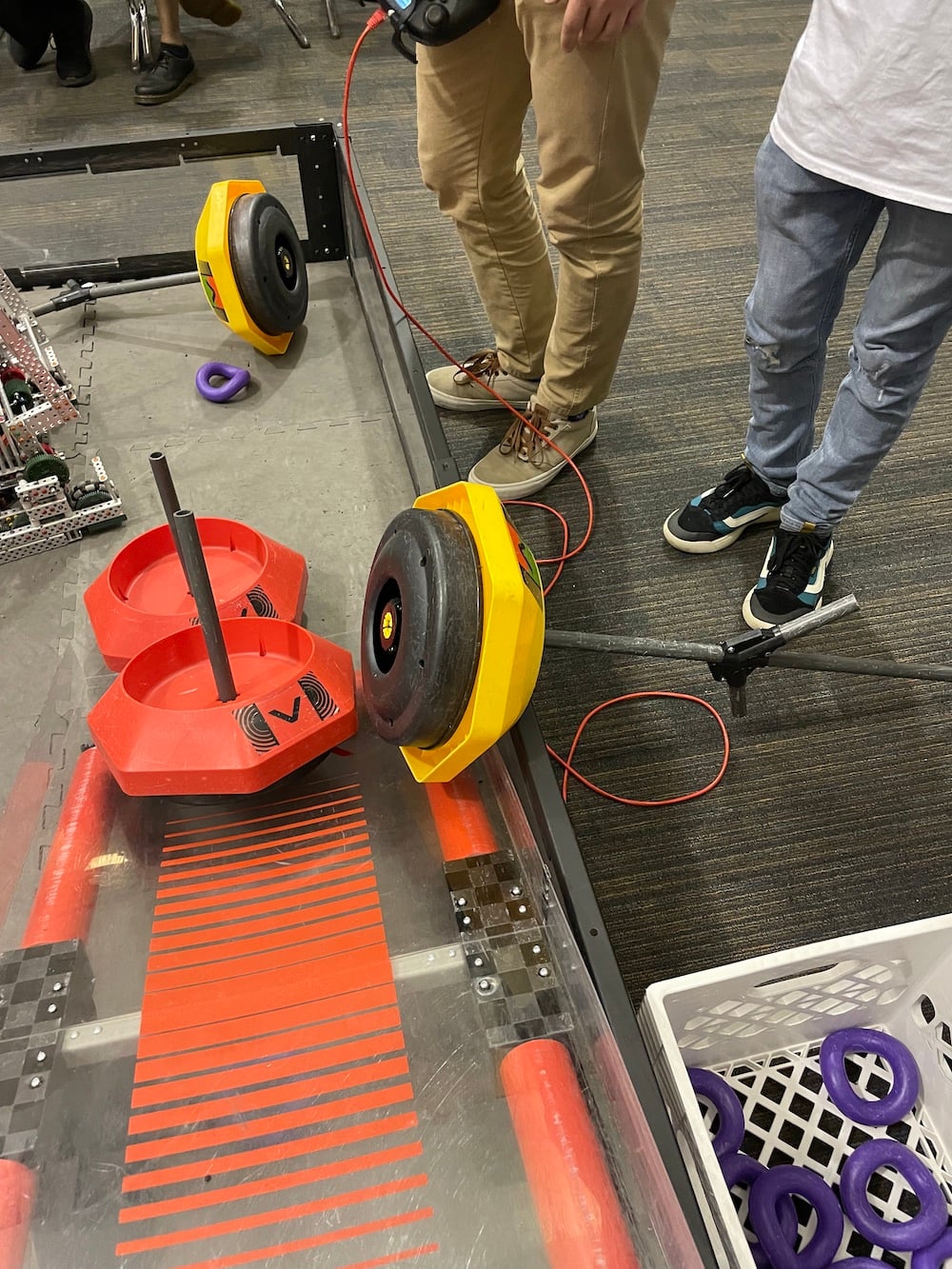

In two recent events, I have seen the tall netural mobile goal legally placed on the platform and fall with the branch going outside the field of play - touching the floor outside the field. 1) The first (pictured) was not on a balanced platform, but it technically meets all of the definitions for being scored in the Home Zone (Scoring Notes 3) since the base was in the 3D of the Home Zone. 2) The second (not pictured) was on a balanced platform while not contacting any other Field Elements, such as foam field tiles or the field perimeter. So, again technically meets all of the definitions of being scored and elevated (Scoring Notes 3 and 6 and definition of Balanced).
The common sense rule may come into play since it is touching the floor outside the field of play ... but if that does and you declare the game object outside the field of play, should it be placed back in the field of play (if not within 30 seconds) SG9? And if so, where would you put it as the "the location nearest the point at which they exited" is on the platform?
![[Example Image]](https://events.vex.com/storage/markdown/uploads/CkIXKMQfVEHjR6MSRpFoNYpwvf6wmeCEk60cDmWX.jpg)

The intent of the Note's second bullet point is to say that as soon as a Scoring Object makes contact with anything outside of the field, it should be considered "out of the field" and dealt with accordingly.
Therefore, the Mobile Goal in the attached image should be considered "out of the field". If the contact occurred during the last 30 seconds of the Match, it should be removed from the field. If it cannot be removed from the field safely and/or in a timely manner, it should simply be considered "not scored".
If the contact occurred before the last 30 seconds of the Match, then the Mobile Goal should be returned to a field tile closest to where it exited. It should not be returned to a Platform.
