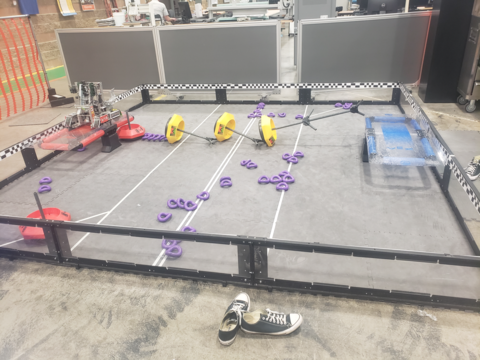

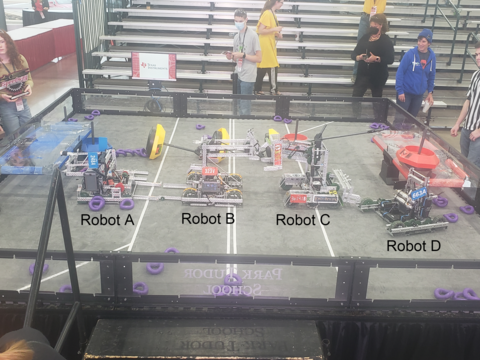

According to this, you can create a scenario of linking scoring objects or robots like in the images below (Image 1 and 2). The image contains 4 robots contacting each other and each end is contacting a platform. The other side contains 4 mobile goals and 6 rings contacting each other and the platforms.

In an event where there are many scoring elements linked together, like the 5 rings included in the chain of scoring elements, would there be a limit to how many of those are transitive?
1a. If all Scoring Elements are not transitive, starting from Mobile Goal A to Mobile Goal D would all elements starting from the blue platform where would the transitive quality stop?
1b. If all Robots are not transitive, starting from Robot A to Robot D would all robots starting from the blue platform where would the transitive quality stop?

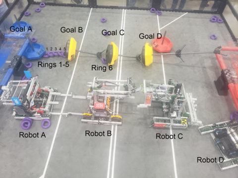

1c. If all elements and robots are transitive, would a robot who tries to climb their own platform be transitively contacting the opposing alliances platform in this scenario and awarding the other alliance an elevated robot. Image for clarification is included. (Image 3)

It is impossible to issue a blanket ruling that will apply to all possible Match scenarios that have led to this (hopefully highly unlikely) scenario. This would result in one of the following possible outcomes:
- A violation of G14 for the Team/Alliance forcing their opponent into an SG3 infraction.
- A 30 point penalty per infraction per SG3 (up to 2x per Alliance).
- A DQ for both Alliances.
Intent, Match context, any prior warnings, etc would all play a role in the Head Referee's judgment call.
