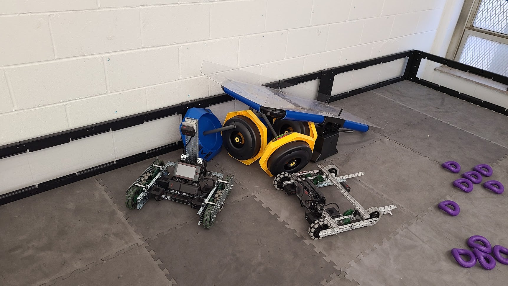

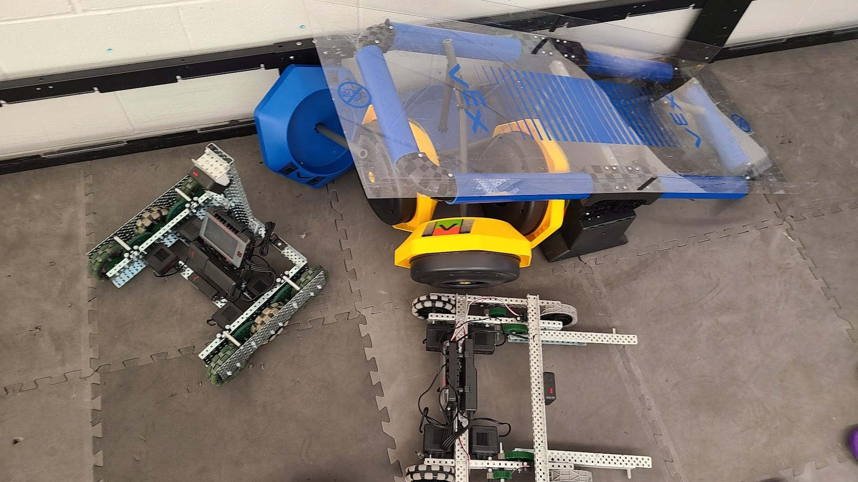

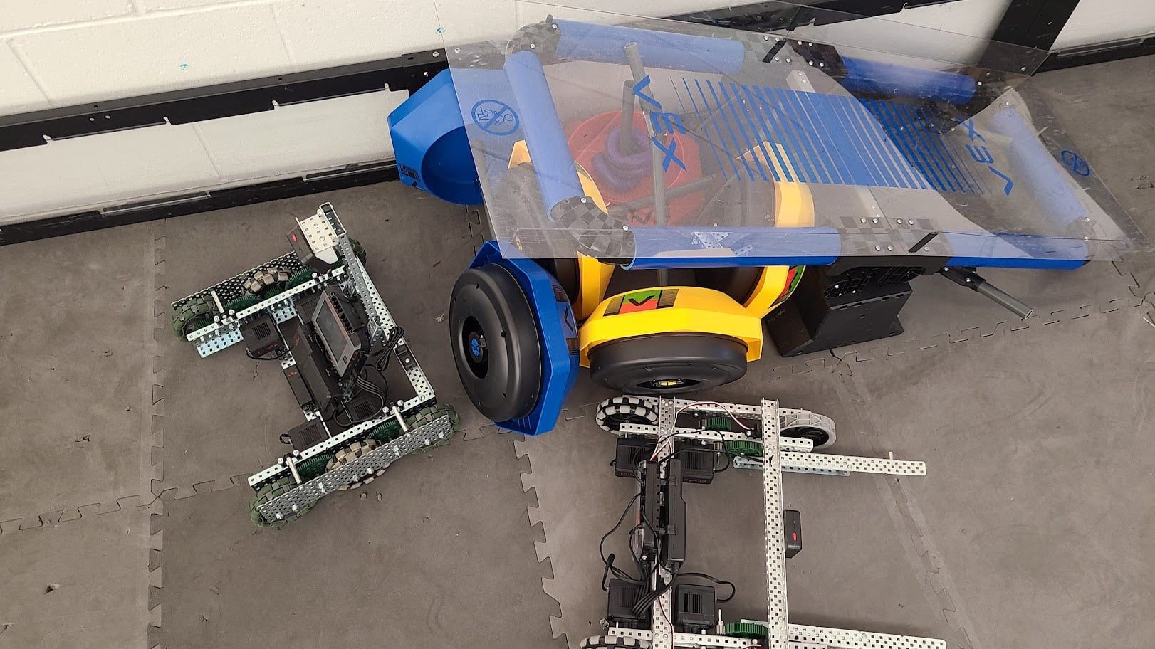

Now my question is about the legality of a strategy implemented by a couple teams around our region which was deemed illegal due to violation of the intent of SG7 due to hoarding. The two teams on an alliance would shove all the neutral goals and their own color goals under their own platform causing the goals to become stuck under the platform, They would then block off access to the portion of the goals that are reachable. Example images of this strategy are attached.
So the questions are
1. If both teams on an alliance are blocking off access to multiple goals (neutral and their own color) by shoving them under their own platform and protecting them from the other alliance, would this by a violation of SG7?
2. If one team on an alliance is blocking off access to multiple goals (neutral and their own color) by shoving them under their own platform and protecting them from the other alliance, would this by a violation of SG7?
3. If both team on an alliance is blocking off access to multiple goals (neutral and their opposing color) by shoving them under their own platform and protecting them from the other alliance, would this by a violation of SG7?
If any of these are no, could you explain why this would not be a violation of the intent of SG7 as they are attempting to stifle game play?
As an Event Partner and a Head Ref, I believe that it is a violation of SG7 as by the intent of locking down game play and because Q&A 940 describes the corners to mean roughly the size of the one foam field tile.
Thank you.
[Example Image] [Example Image] [Example Image]

Thank you for taking the time to provide extensive examples and quotes from the Game Manual. The v2.2 Game Manual update included revisions to the definitions of Possession and Hoarding, as well as <SG7>, that we feel address this question. We recommend reviewing the new definitions and rules, including the “red box” clarifications in <SG7>, for more information.
Notably, this included separating “Hoarding” such that it is no longer defined as “a form of Possession”, and the following addition to its definition:
Hoarding may occur anywhere around the field perimeter and / or Platforms; there is no requirement for it to be in a specific corner of the field.
Therefore, under these new definitions/rules, the attached images would be considered Hoarding and therefore a violation of <SG7>.
