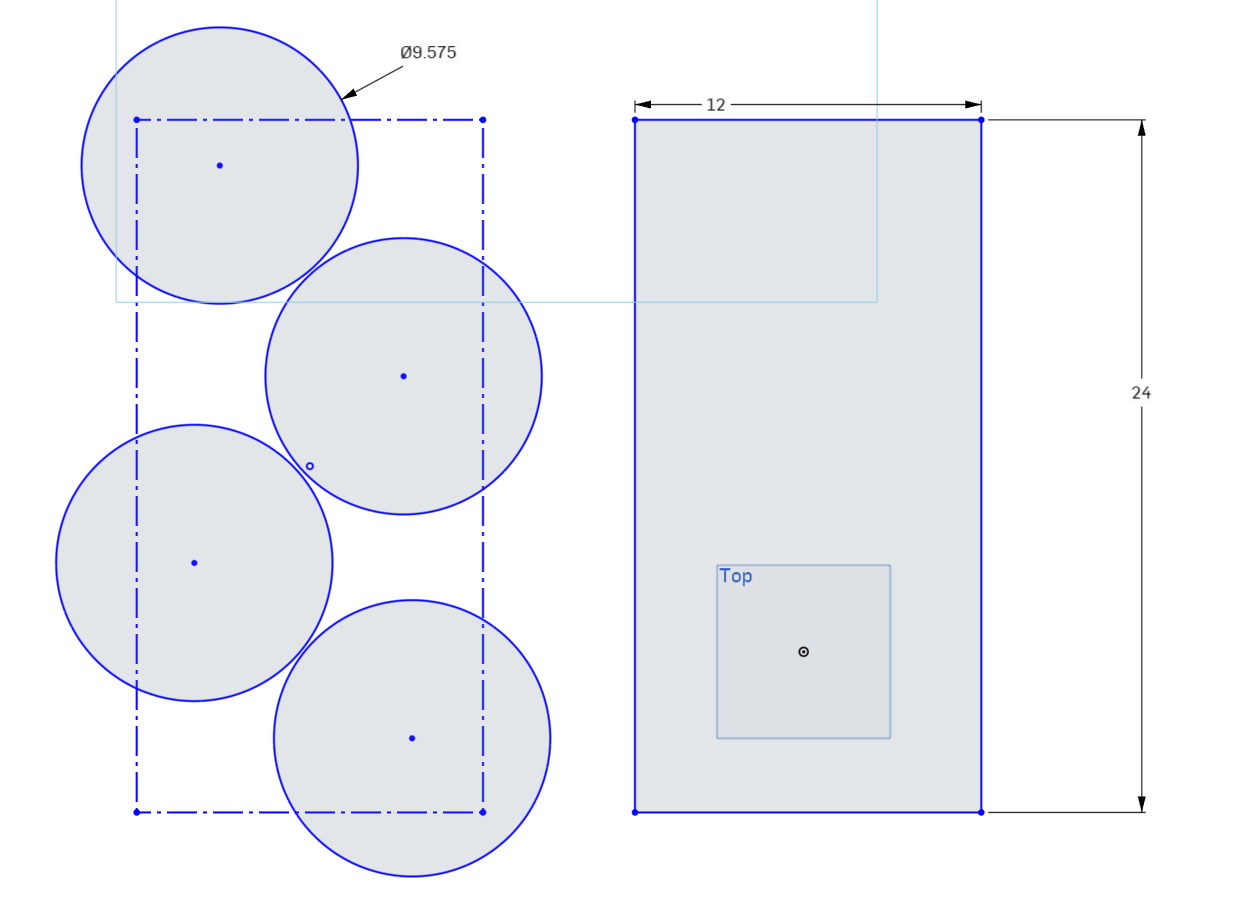

Attached are two images, both rectangles are 12"x24". The highlighted portions of both sheets are equal in surface area, but the left couldn't be reassembled into a 12"x24" sheet.
  1. Is the plastic limit based on reassembling parts into a 12”x24” sheet, or is it based on total surface area?
    a) If it’s based on surface area, how are holes within parts accounted for? Are holes/pocketing subtracted from the total surface area of the part?
    b) How should competitors prove the surface area of complex parts to inspectors and referees?
Thank you for your time! [Example Image]

Thank you for bringing this to our attention and for attaching an example image. It turns out that "theoretically nesting into a single 12"x24" sheet" is not functionally the same as the total surface area exceeding 288 square inches. The answer to Q&A 975 has been updated, and R10 will be clarified further in a future Game Manual update.
The former. However, the other portion of the answer from Q&A 975 is still correct - Teams are not required to literally use a single 12"x24" sheet of plastic.

The intent behind the requirement being "nest into a single sheet" instead of "288 square inches" is specifically to reduce complexity during inspection. In most cases, inspectors should be able to tell "at a glance" whether a given Robot is exceeding the permitted area (such as having four 9.5" diameter circles).
If a Robot is "pushing the limit", such as by having many small CNC'd parts that are nested perfectly to fit in a 12"x24" space, it would be within an inspector's authority to request a demonstration or documentation of the parts' legality. We would not expect this request be an issue, for Teams who are abiding by the rule; generally speaking, a Team who is pushing the limit to this extent knows that they are doing so, and this type of detailed Robot design work is a perfect example of documentation that should be included in an Engineering Notebook anyways.
