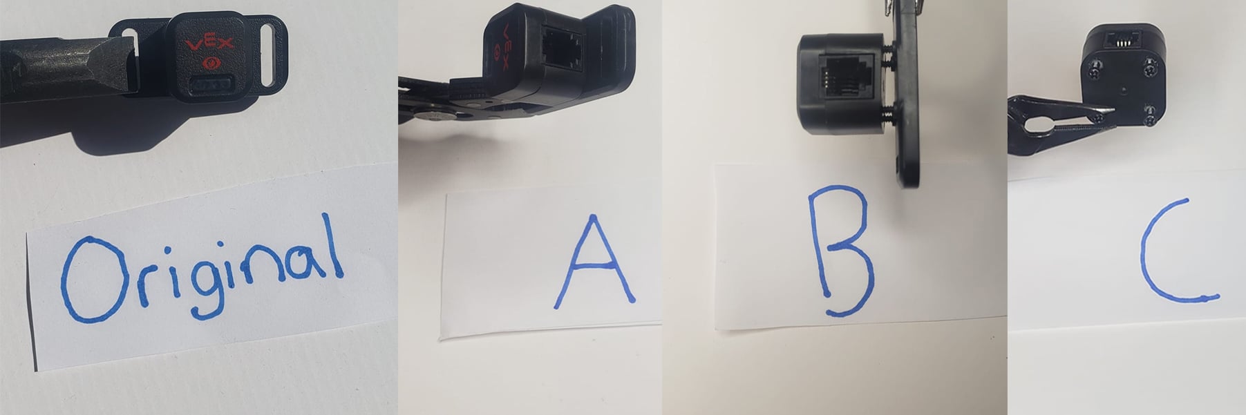

- Figure A- Can we rotate the sensor block 90 degrees from it's base plate?
- Figure B- Can we loosen the screws that connect the sensor to the base plate?
- Figure C- Can we remove the base plate but use the screws to attach the sensor to a custom polycarbonate base plate?
Our intention for doing this is to improve wire management and mounting on to the C channels. Figure A,B, and C only improves the placement of the sensor to the build and does not effect the sensor's internal workings.

There are 2 parts of the Optical and Distance sensor: Block and flat piece which they are mounted on. Is it legal to rotate the block area 90 degrees
![[Example Image]](https://events.vex.com/storage/markdown/uploads/gJ0pZsWOih2QWyT1QEGGWcPZtTmSIwgBFqxnDQ0E.jpg)
Yes; this is an intended user-serviceable feature of the V5 Optical Sensor and V5 Distance Sensor.
No, these would not be permitted.
