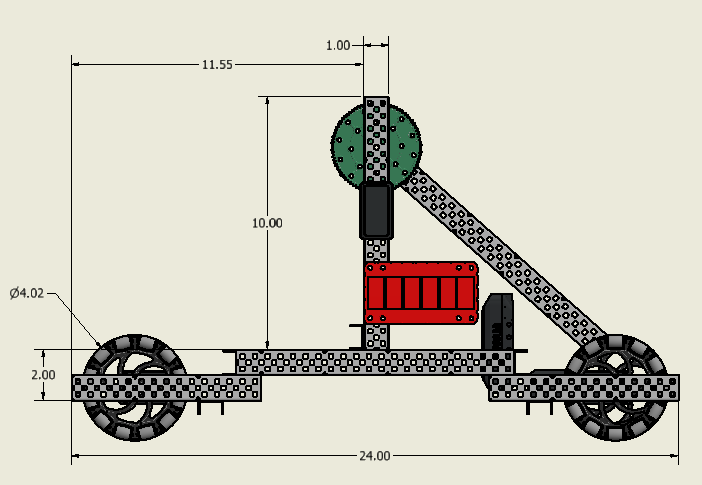

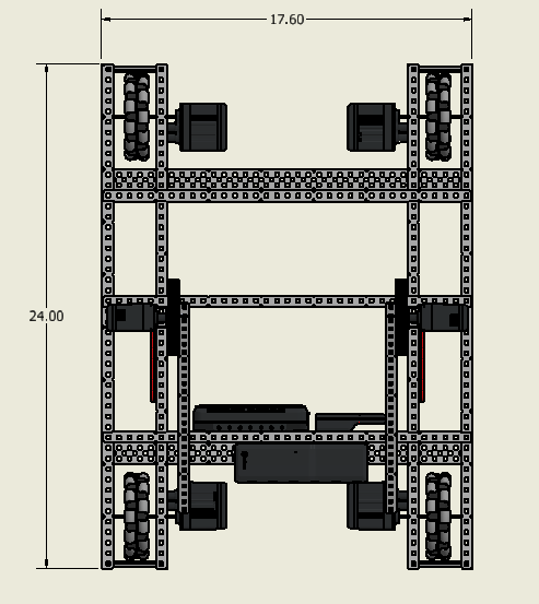

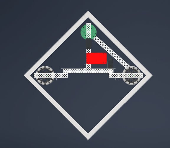

The robot in the attached images, when rested on its four wheels, has a greatest size of 29.76” in the two dimensions parallel to the foam field tiles. It is able to fit into an 18” cube, just not in the customary way. I see nothing in the rules that suggests an orientation that the sizing cube must be relative to parts of a robot or to the field. The square in one of the pictures has internal dimensions of 18”x18”.
I have the following questions about this robot
Given that it fits within an 18” cube and does not violate the 24” “virtual ceiling”, is it legal to use a robot with the dimensions of the robot in the attached images as-is with all 4 wheels contacting the ground?
If the answer to part 1 is no, would this robot be legal to use if it started the match in a different orientation? Would there be any constraints on how the robot could move or orient itself once a match starts?
Regardless of how it is used or not used during actual matches, should a robot with the dimensions of the robot in the attached images pass inspection?

- Given that it fits within an 18” cube and does not violate the 24” “virtual ceiling”, is it legal to use a robot with the dimensions of the robot in the attached images as-is with all 4 wheels contacting the ground?
With that common-sense interpretation of the sizing rule in mind, the two parts of this question are in conflict with each other. The depicted Robot, with all four wheels contacting the ground, would not fit within a cube which is 18" wide.
- If the answer to part 1 is no, would this robot be legal to use if it started the match in a different orientation? Would there be any constraints on how the robot could move or orient itself once a match starts?
Yes. If the Robot started on its side, as depicted in the third attached image (assuming that the image is from a top-down angle), it would satisfy the constraints of G4. However, as pictured, it would likely be unable to move once the Match has begun without violating SG4 or SG5.
- Regardless of how it is used or not used during actual matches, should a robot with the dimensions of the robot in the attached images pass inspection?
This would depend on if the inspector was only strictly following the technical interpretation of R5, in which case the Robot would likely pass if inspected while resting on its side. However, a secondary purpose of the inspection process is to help Teams identify potential problems with their Robots before reaching the field and committing an illegal action. We would hope that this inspector would notice that the Robot would immediately violate G4 when it is placed with all four wheels on the ground, and advise the Team to modify their design.
