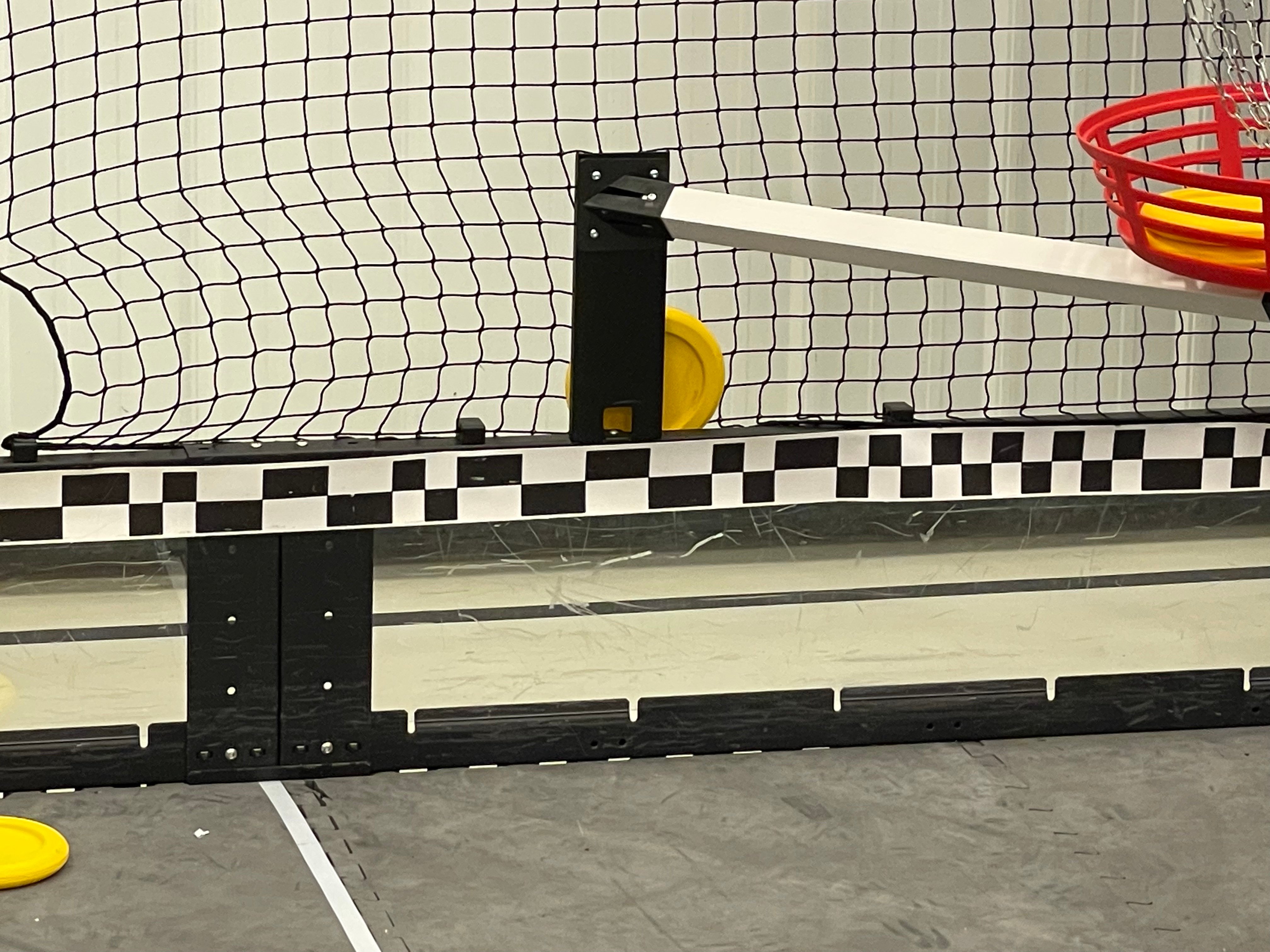

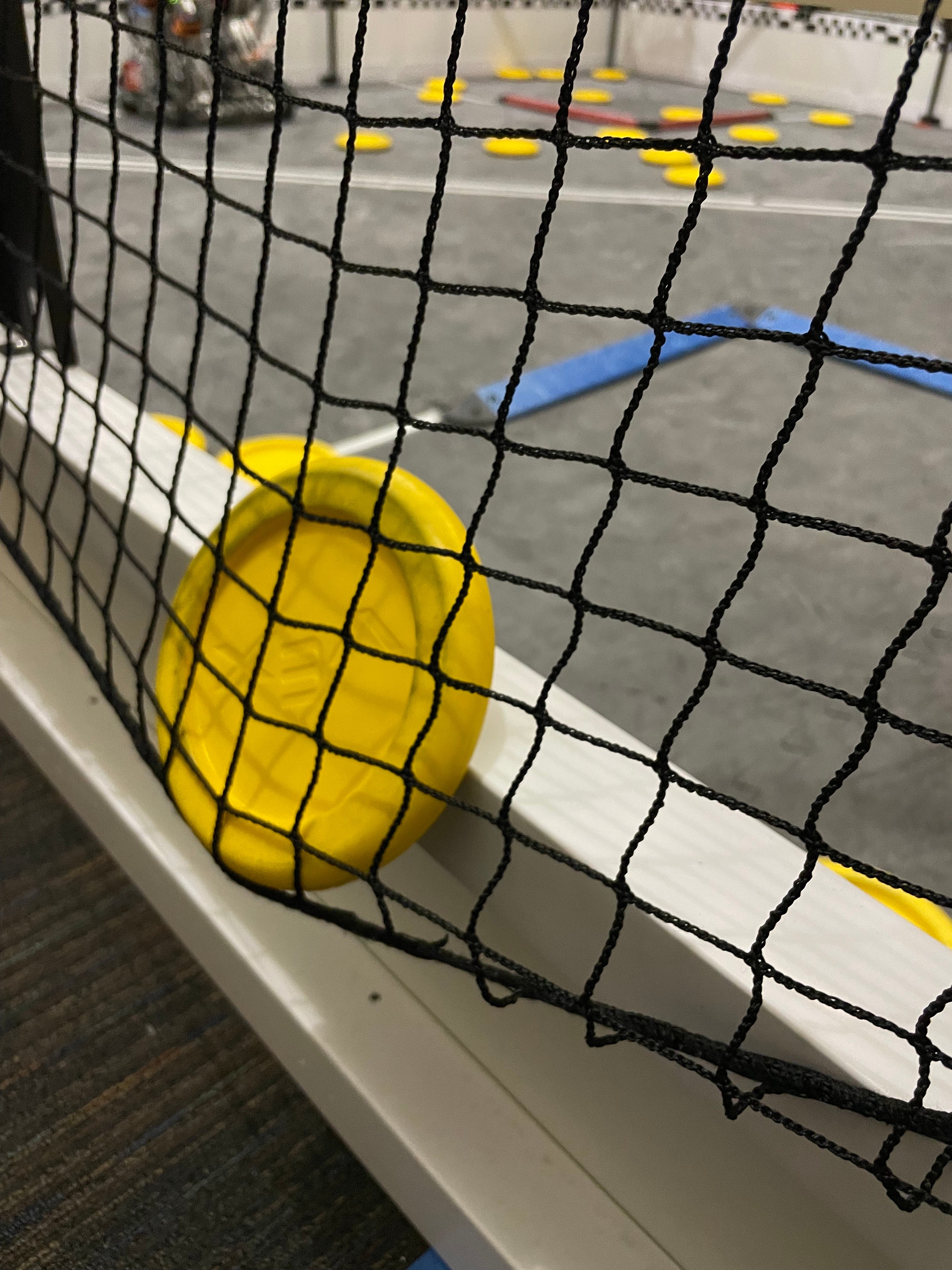

- If a disc is caught in the net and touching the outside of the field perimeter or the far corner of the field (see pictures), is this considered out of play (the end game rule clearly says that the outside of the field perimeter is out of play) and thus the referees should move this into the low goal (just like a disc that slips through the net)?

![[Example Image]](https://events.vex.com/storage/markdown/uploads/3468NYUz3ppporPIiEJfEh0o8ZlEQ1juDlUmG2z0.jpg)
![[Example Image]](https://events.vex.com/storage/markdown/uploads/D8t0J30yqn9I25xqCqyLIxTvllRtUppt271f1Elk.jpg)
A Disc that leaves the Field but remains caught in the Net should be considered as having left the Field, and should be returned to the Field near where it exited as described in rule <SG9> and Q&A 1320.
