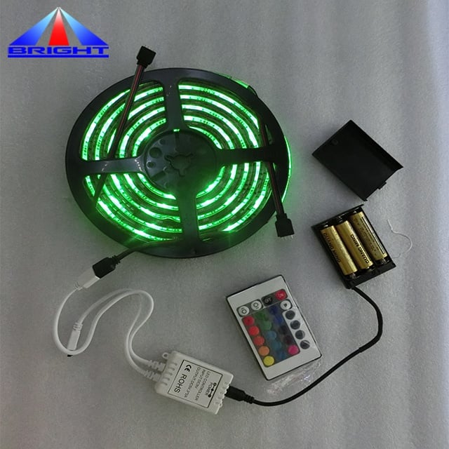

Cameras contain microcontrollers and per <R12b> are legal for use as a non-functional decoration without an exception stated for <R14>. <R12g> permits the use of LEDs and also does not contain an exception for <R14>, however addressable LED light strips can use microcontrollers, such as the one in the picture below.
[Example Image]
Scenario A: a robot uses an LED light strip with an RGB controller but without a remote, no wireless communication is used for the LEDs.
Scenario B: a robot uses an LED light strip with an RGB controller and with a remote. Wireless communication is used from the remote to the RGB controller.
Scenario C: a robot uses an LED light strip with an RGB controller that connects to both the LED light strip and the V5 brain through one or more 3-Wire ports. The V5 brain sends a signal to the RGB controller, which is used to set the LEDs.
Scenario D: a robot uses an LED light strip without an RGB controller and is connected directly to the V5 brain through one or more 3-Wire ports. The V5 brain is used to set the LEDs.
In which scenarios would LEDs be considered non-functional decorations?
Answered by committee
These are all correct statements.
Scenarios A, B, and C would all be considered violations of R14, since they include a microcontroller.
Scenario D is legal.
