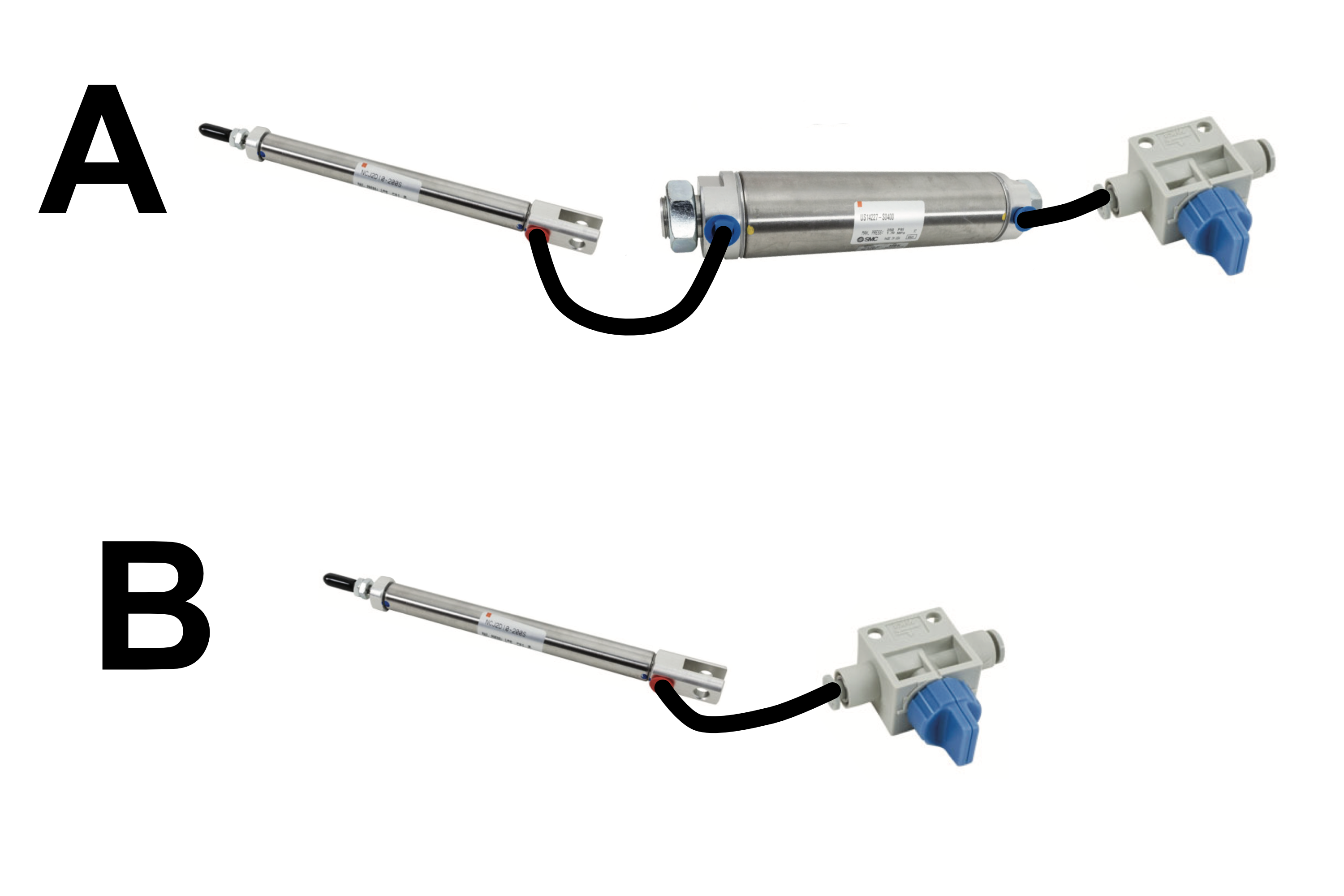

The attached image shows two configurations of pneumatic components with no solenoid. When the shutoff valves are closed, the cylinders essentially behave as gas shocks. The force of the gas shock can be great enough to replace rubber bands in some robot applications, particularly if configuration "B" is used and the system is first charged to grater-than-atmospheric pressure.

  3. Would configuration "B" in the attached image (where the cylinder is connected directly to a shutoff valve with no reservior) be legal? Q&A 1209 concerns using pneumatic components without a reservoir, however this configuration is somewhat different to the use case described in that question.

As noted in Q&A 1209, the use of pneumatic tubing and/or cylinders solely for the purposes of storing air without pneumatic tanks is not permitted. Therefore, example "B" would not be legal.
Example "A" satisfies this requirement and would therefore be legal.
