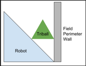

  1. If a Robot suspends a Triball in the air using a tilted flat surface so that it is held between the Robot and the Field Perimeter Wall, would this be considered possession?
  2. If the answer to #1 is yes, would the answer change if the flat surface is vertical? Therefore, the pressure of a Robot driving into the Triball keeps it up. [Example Image]
Answered by committee
23-Jun-2023
Thank you for including the image with your question. Generally speaking, yes, these actions would be considered "holding" or "controlling the movement of a Triball" as described in the definition of Possession.
However, as always, it is impossible to provide a blanket answer that will encompass all possible hypothetical Robot mechanisms/interactions. This answer is not intended to refer to every instance that a Robot, a Triball, and the field perimeter touch one another. In most cases, incidental contact while driving around the field would fall under the "momentary" reference in SG7.
