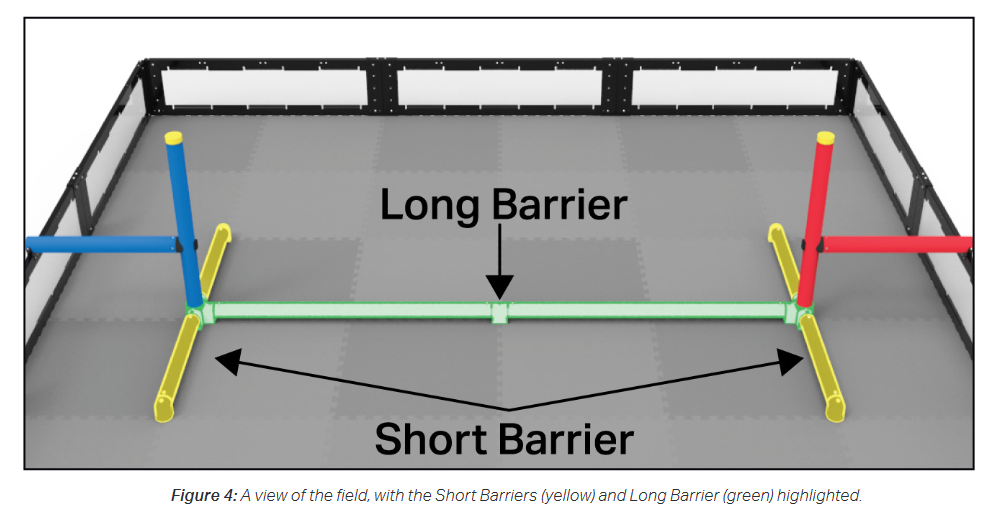

Barrier – The black structure, made up of 2” Schedule 40 PVC pipe (with a 2.375” outer diameter) PVC pipe and associated connectors/hardware, that sits in the middle of the field. For some rules, the Barrier is divided into one Long Barrier and two Short Barriers, but it is usually referred to collectively as just “the Barrier.”
[Example Image]

With 35 seconds to go, a blue robot elevates itself by only contacting the long and short barriers, the blue robot is very close to, but not touching, the red elevation bars. The robot is therefore considered elevated as per the definitions of the barrier and elevated and is therefore protected by <SG11> in the last 30 seconds,
With 25 seconds left, a red robot begins an attempt to climb the red elevation bar. The red robot is in contact with the red elevation bar, so is protected by <SG11> when it hits the blue robot, which is elevated, so is protected by <SG11>
