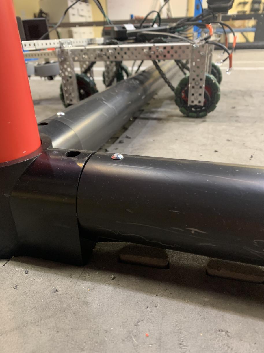

<SG8><SG8>It is stated in the manual that double-zoning occurs when both teams are contacting tiles on the same side of the field. It is also stated that contacting the long bar separating the two zones ends a double-zone. What would happen in a scenario as shown in the image with a robot contacting the tiles on both sides of the bar, yet not contacting the bar itself? would it be considered double-zoning no matter what? img

Per the definition of Double Zone, the Robot you describe is in contact with both Offensive Zones. A Robot that is in contact with both Offensive zones counts toward a Double Zoned status in any situation in which their Alliance partner is in contact with the gray tiles and not in contact with the Long Barrier or Elevation Bars.
