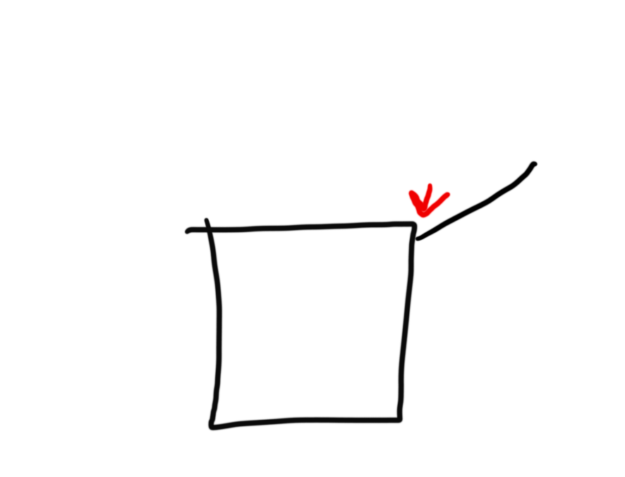

A) The below indicated with a red arrow is a concave space, the Triball would move with the robot when it changes direction (e.g. turns), but would this be considered possession?![[Example Image]](https://events.vex.com/storage/markdown/uploads/MdfUS8XUaL9ZupvY8SsPBYCrCSqfPeHjritTdKOl.png)

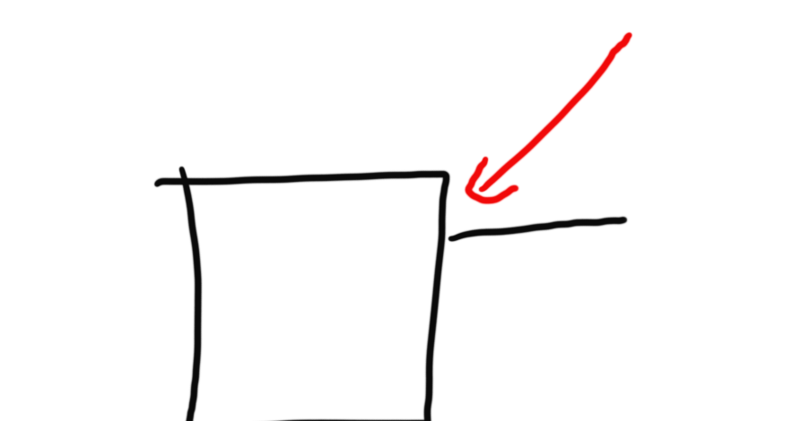

B) This below indicated with a red arrow is also concave and also permits the Robot to control the movement of the Triball. Is this considered possession? ![[Example Image]](https://events.vex.com/storage/markdown/uploads/OHNsVksL89nQx0fxYZFdSLMvbzSTywhYLjtwyfri.png)

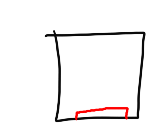

C) The below rectangle indicated with a red box is a concave space. Would this be considered possesion? How deep into a Robot must a Triball be to be considered possession? In the case where a Robot can strafe/move laterally, would it be considered possession if the Robot is plowing in addition to holding a Triball in a concave space? ![[Example Image]](https://events.vex.com/storage/markdown/uploads/pKPoKSJEZ0pZljpM5toDW9yr8focDfTu1o7tSMYw.png)

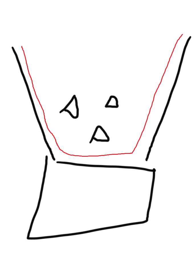

D) The below image is a giant funnel that would control the movement of the Triballs, but at some point the Triballs would fall out if the Robot is turning. Would this be considered possession? ![[Example Image]](https://events.vex.com/storage/markdown/uploads/MM6zzdPUIuwHLkmXp40hKVGnZAmaChA5AnYuNWxD.png)

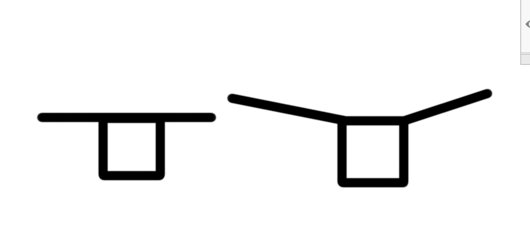

E) The below images are more likely implementations that we might see. The right side design would have more control than the left given the geometry. How much control can have over a Triball(s) before it is considered Possession of more than one?

Examples A, B, C, and D - yes, these meet the intended definition of Possession.
Example E - Generally speaking, these mechanisms fall into three categories when interacting with Triballs.
(_______) - Definitely Possession
________ - Definitely Plowing
.______. - "Gray area" between Possession and Plowing
The third type of scenario requires some human / Head Referee judgment to determine which side of the line it falls on. For example, if it is a mechanism or face which is clearly designed to be flat, but incidentally bends inwards due to damage midway through a Match, then it is likely that only a warning or Minor Violation would be awarded. The incident only happened once, the Team has demonstrated intended compliance with the rule, and the Robot's behavior when interacting with Triballs is likely closer to Plowing than Possession.
If, on the other hand, the mechanism's "wings" had hard stops that only allowed them to open as far as is shown in your sketch, then it would be clear that there is no intention to comply with the stated definition of Plowing.
To provide another way to think about this difference... when reviewing a face, mechanism, or interaction, it is much easier to prove that "yes, this is Plowing", and much harder to prove that "no, it's not Possession". If it is flat or convex when placed against a wall, then you should be good to go - it is almost impossible to be considered Possession. If not, then you know that you're in a gray area, and that it risks a warning at minimum. And, as always, multiple warnings / Minor Violations may escalate to a Major Violation at the Head Referee's discretion.
