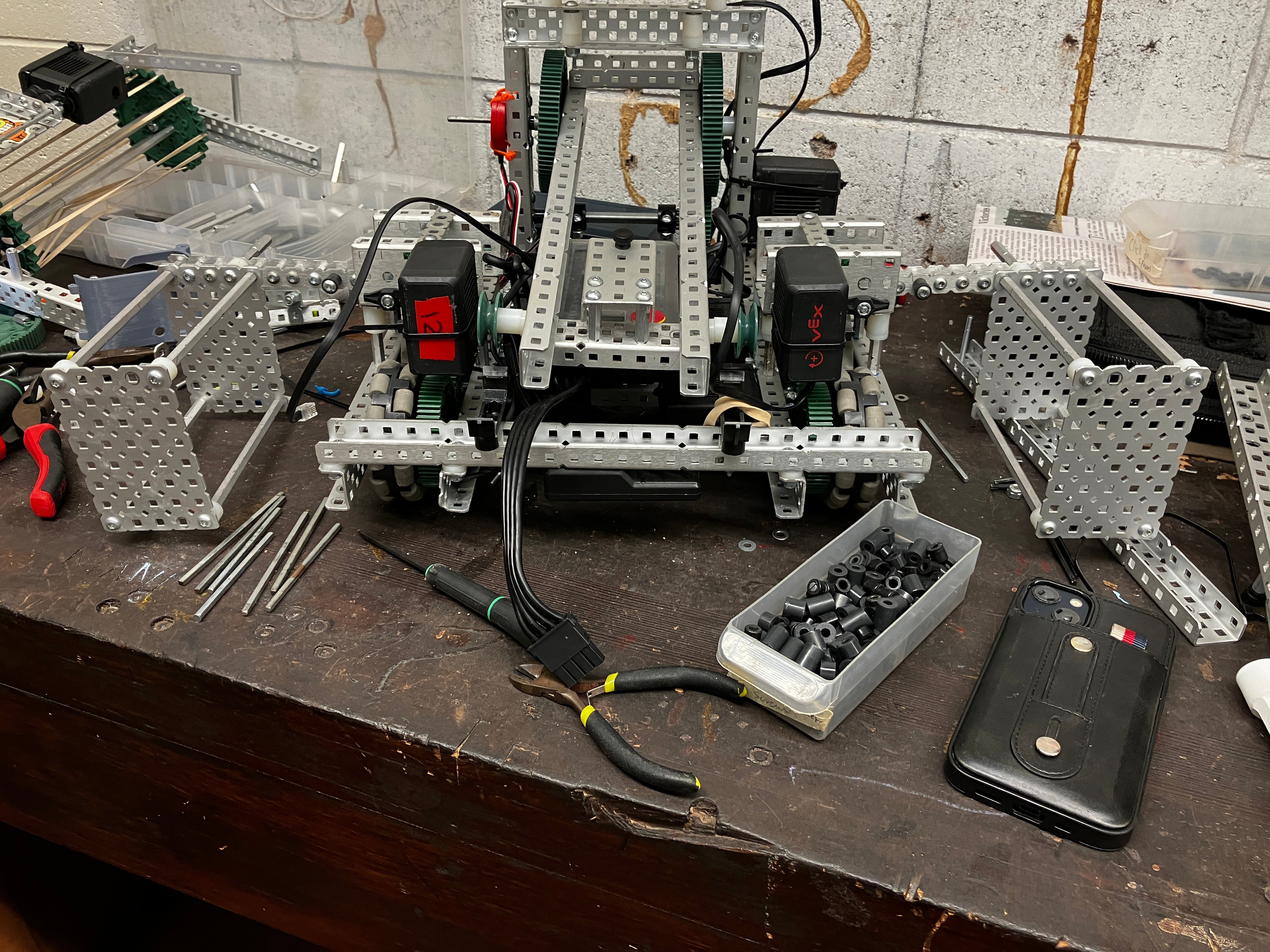

We are wanting to clarify whether or not the small gaps left by our plowing mechanism are considered concave or not.

Answered by committee
2-Nov-2023
