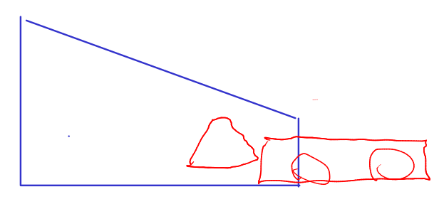

Particularly in autonomous robots score their alliance triball within the opponents goal. Scoring this can be challenging without breaking the plane of the goal resulting in SG8 violations being frequent and furthermore with the somewhat contradictory goal bounds only being for the purposes of scoring interpretations for breaking the plane of the goal these range from:
1: Going under the goal (this is a clear violation when considering the spirit of the rules) - second image

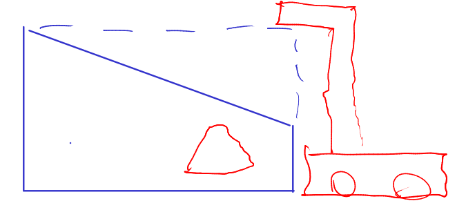

2: Going above the goal such as a mechansim for intaking triballs riding up the goal as the bot approaches- Third image

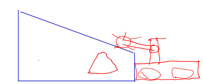

3: Going above the total height of the goal presented in the goal bounding image - fourth image

- Should the plane of the goal be treated as an infinite vertical projection, where case three would be a violation?
- Should robots interacting above the goal be a violation at all such as a robot which has a roller for grabbing the triballs rolling up the top side of the net, designed in a way in which it avoids entanglement as it pushes the triball in?

No. The plane of the Goal is not an infinite vertical projection, it is a projection downard onto the field below the surface of the net. Figure 16 is intended to demonstrate which PVC pipes are being referenced, how the planes interact with the bases, etc.
No. Robots interacting above the Goal is not a Violation if they are not Entangled with the Net.
