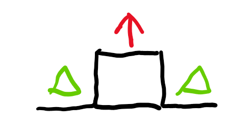

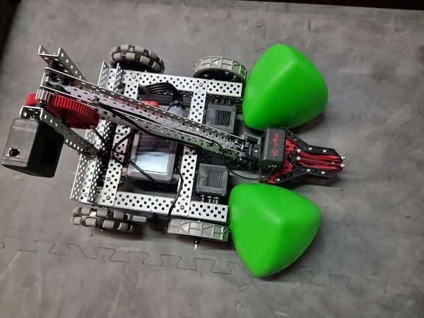

Some examples of the relevance of this A robot is possessing a triball, it additionally has a concavity on the front (U shape) such as in the second drawn robot image or first clawbot image. This robot would under this interpretation be in possession of two triballs and in violation if driving with no attempt to remove these triballs.
Would this be a violation if the robot drove forwards only - with the triball not interacting with the sides of the concavity? or does possession require multiple faces interacting with the triball to receive a violation.
Furthermore the second drawn image displays a robot with a concavity formed from two perpendicular components. If neither triball plowed by the front plate interact with the perpendicular bar is the existence of a concavity enough for a violation?

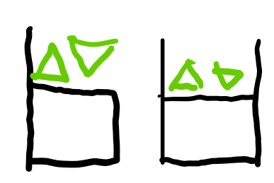

The last drawn robot contains two concavities with triballs within, a turn of the robot would control one triball but not the other- while a turn the other direction would control vice versa. Would this be a violation due to possession of two triballs. A second example is the clawbot with its claw separating each triball.
