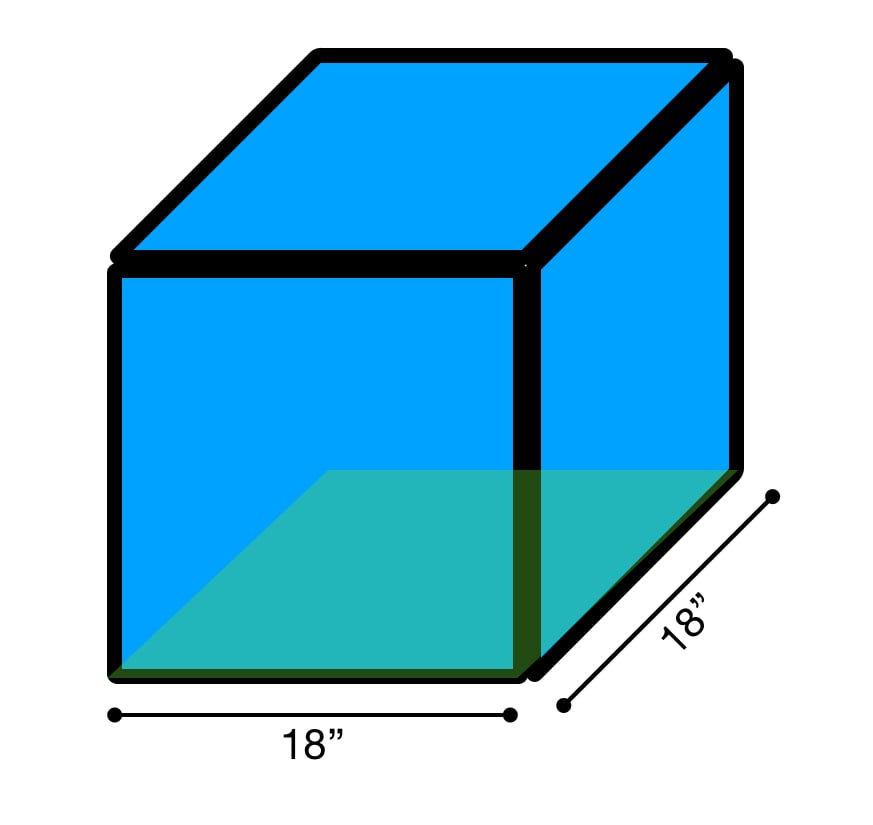

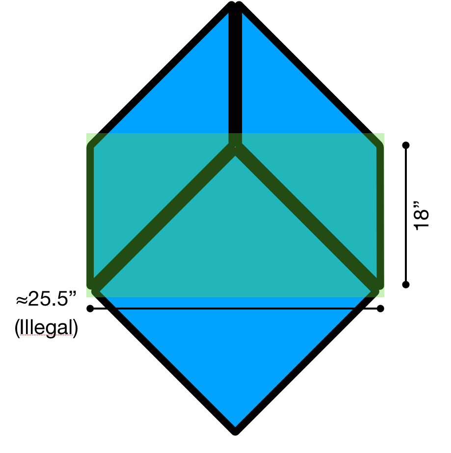

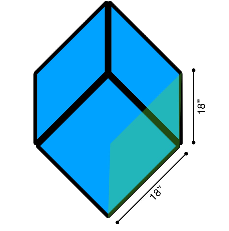

Does this same logic apply to <G5> and the Robot’s 18”x18”x18” starting volume (mainly as it pertains to rotating while Climbing)?
I have included two figures below of different interpretations. Figure A is for reference; it represents an 18”x18”x18” Robot on the Floor. Figure B depicts a Robot vertically rotated 45°, measured relative to the base of the Robot. Figure C also depicts a Robot vertically rotated 45°, but it is still measured relative to the Floor, putting it an illegal 25.5” length. Would Figure B or C be the correct interpretation?
Figure A:

Figure B:
![[Example Image]](https://events.vex.com/storage/markdown/uploads/aIVGiP1ZSLrG5QcvTcS0d5oIEy3okvw02yO1Yq5V.jpg)
Figure C:
![[Example Image]](https://events.vex.com/storage/markdown/uploads/ClkhW269qiiSZVxoI0k5QlDvse4MwU3KxhcBptzm.jpg)
No. The full text of <G5> reads as follows, with a few portions bolded for emphasis: "Robots begin the Match in the starting volume. At the beginning of a Match, each Robot must be smaller than a volume of 18” (457.2 mm) long by 18” (457.2 mm) wide by 18” (457.2 mm) tall."
A common-sense interpretation (<G3>) of the words "long", "wide", and "tall" make it clear to any reasonably astute inspector / Head Referee that the sizing "cube" in question is resting flat on a foam tile.
Therefore, your Figure C would be closest to the correct interpretation, and would be both illegally long and illegally tall in that starting configuration.
