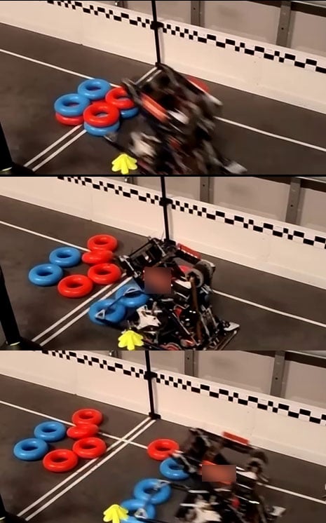

In a “Ring Rush” a robot (let’s say a blue robot for clarity) rapidly goes toward the eight rings on the autonomous line -- gameplay elements intended to be utilized by either Alliance during the Autonomous Period. The robot pushes the top two red rings off the two lower blue rings so they can intake the two blue rings. In doing so, the blue robot pushes the four rings on the top of the stack (two blue and two red) into or further into the opposing alliance side. These rings can travel at least one ring diameter into the red side of the field. See photo sequence for clarification.

Again, for the sake of clarity, assume that the four rings end up on the other side of the autonomous line a significant distance from where they started (as in the pictures). Question 1: What constitutes “messing up” or “interfering with” an opponent’s autonomous routine to the level of an <SG7>> violation? Obviously taking rings from them is okay, but is putting several rings from the autonomous line into their path interfering (assuming the opposing alliance robot goes to that part of the field)?

[Example Image]

As we said in our answer for Q&A 2421, "Knocking over a stack of Rings that begins on the Autonomous Line is still legal even if it results in an opponent picking up the "wrong" color of Ring during the Autonomous Period. It's part of the risk described in rule <SG9>." Rushing to the Rings and making a mess of the stack to extract the Rings of your color is fine.
Messing up the stack to such an extreme that you interfere with opponent Autonomous routines that aren't trying to interact with those stacks should be considered a strategic or egregious offense and a Violation of rule <SG7> through <G17>. The Team should not be eligible to receive any part of the Autonomous Bonus or an Autonomous Win Point.
