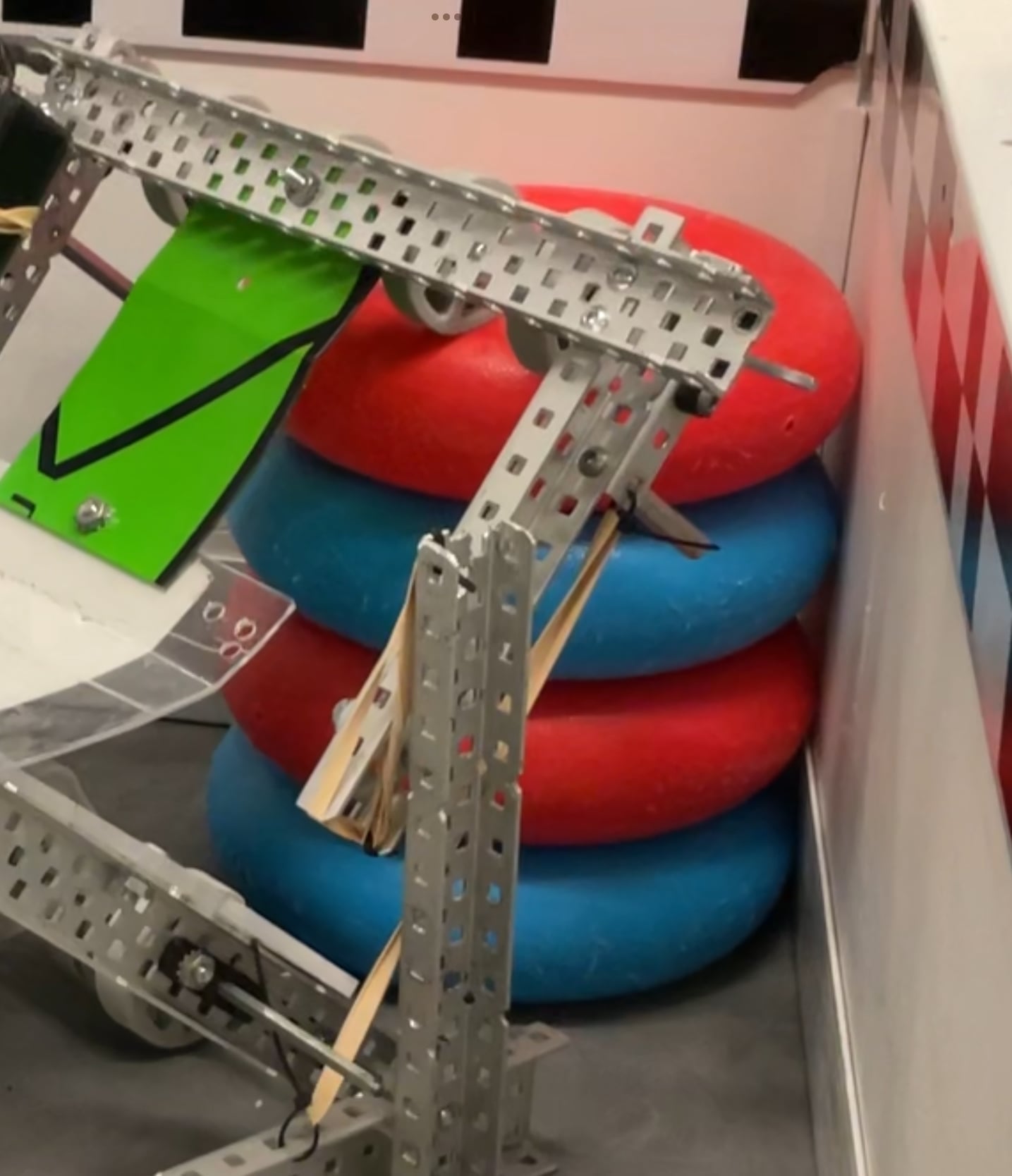

Regarding <SG6>, will a robot be considered violating the possession limit of rings if it has its roller intake mechanisms over the 4 ring stack and intakes all 4 rings from top to bottom as shown in the image, given the robot is only contacting 2 rings at a time.
[Example Image]
Answered by committee
13-Mar-2025
If the Robot intakes one Ring at a time, and is only in Possession of one or two Rings at a time, it is not in Violation of rule <SG6>.
If the Robot intakes all four Rings simultaneously, it is in Possession of all four Rings and is in Violation of rule <SG6>.
