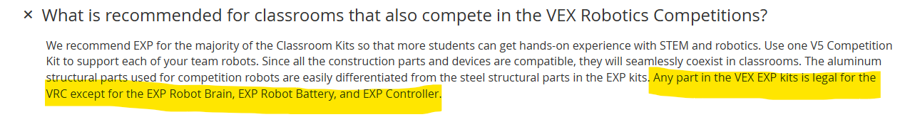

The following statement is on the VEX website under the EXP FAQ "Any part in the VEX EXP kits is legal for the VRC except for the EXP Robot Brain, EXP Robot Battery, and EXP Controller". Statement is highlighted in screenshot below taken on June 21, 2025. [Example Image]

Question 1: No. The statement on the VEX Website under the EXP FAQ is incorrect, and will be updated.
