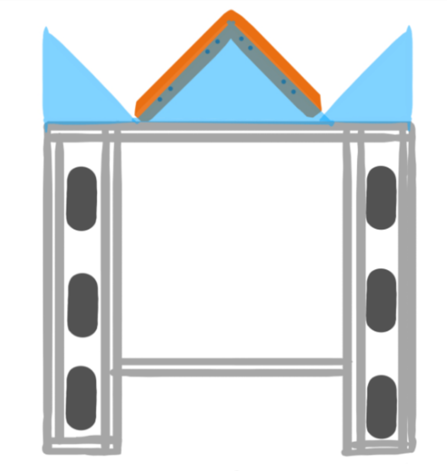

<GG9><GG9> “Robots may not intentionally grasp, grapple, hook, attach to or otherwise Entangle with any Field Elements. Strategies with mechanisms that react against multiple sides of a Field Element in an effort to latch or clamp onto said Field Element are prohibited. The intent of this rule is to prevent Teams from unintentionally damaging the Field and/or from anchoring to or otherwise Entangling themselves with the Field.” Firstly, would it be possible to define each of the terms used in the ruling, seeing as they lack clarity. Grasp, Grapple, Hook, Attach To, Latch, Clamp, React, and Anchor are not defined within the rulebook. Merriam Webster defines clamping as, “to put securely in place or in a desired position.” Going from this definition, at what point is a robot using an aligner which resists a change in motion imparted from another robot considered in violation of GG9? Is the robot in violation for just aligning to the goal, as it is in a desired position? What specific physical conditions, or restrictions of motion, would a robot have to be in violation of GG9? Could the Game Design Committee come up with a clearer definition for each of the aforementioned terms, as the current definitions are too vague to be consistently applied correctly by head referees?

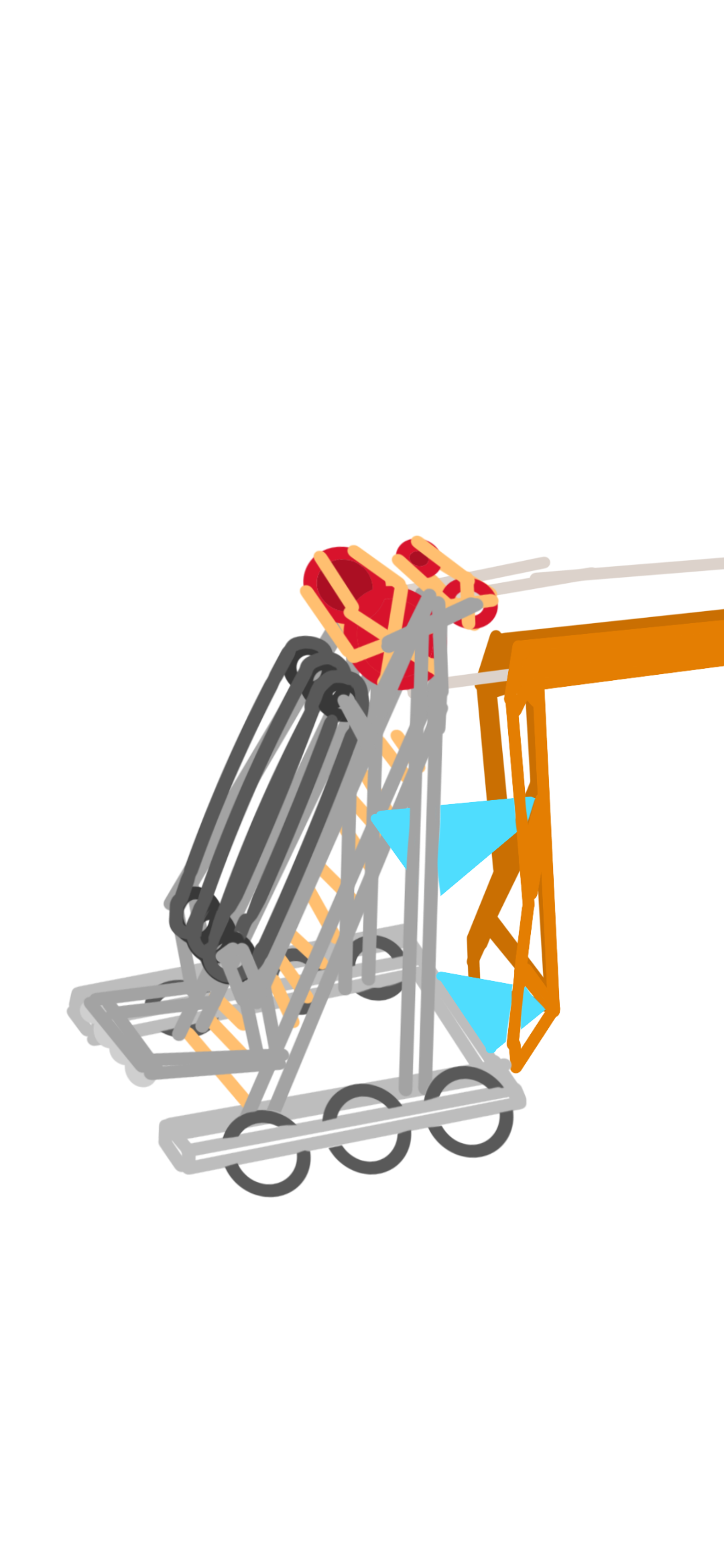

Below are a couple of examples of potential GG9 violations: Double Triangle Shaped Aligner: Bird’s Eye View: [Example Image]

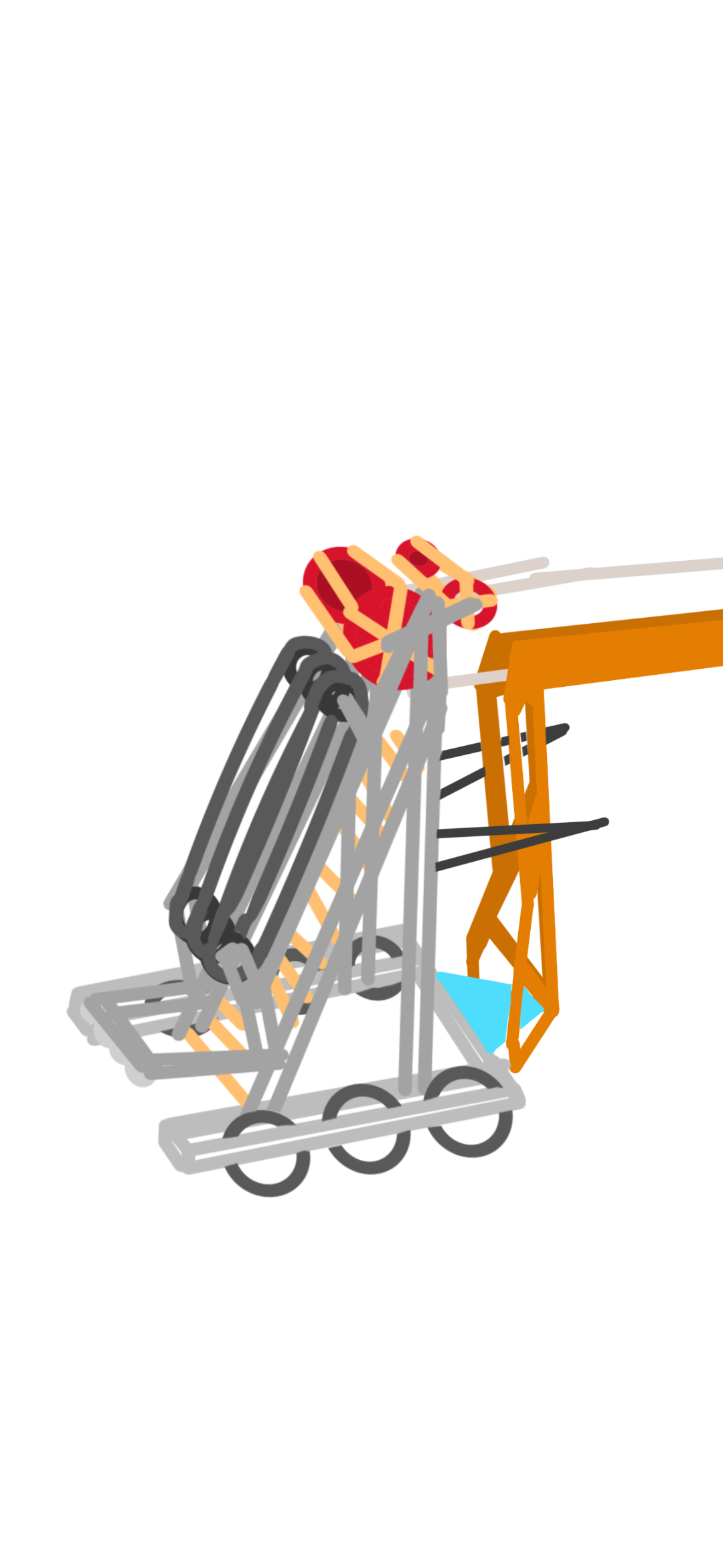

Does having multiple robot mechanisms at different heights interacting with a goal change the ruling?

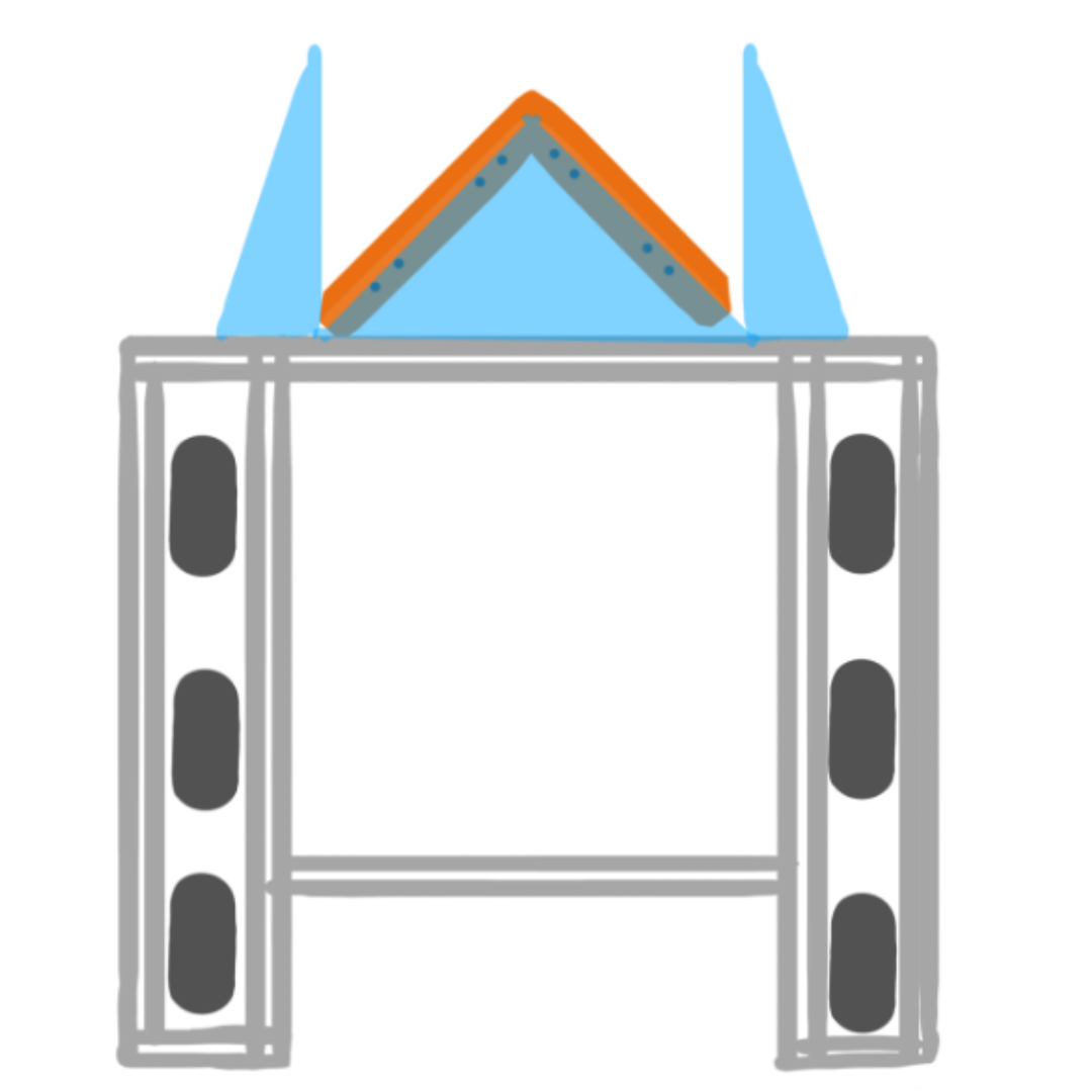

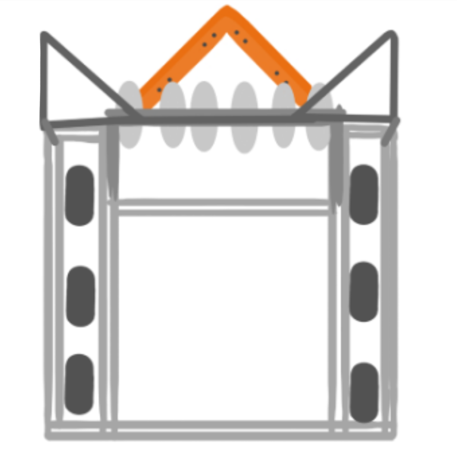

Different Types of Aligner: Flexwheels and V-Shape Aligner: Top Down View:
[Example Image] [Example Image]

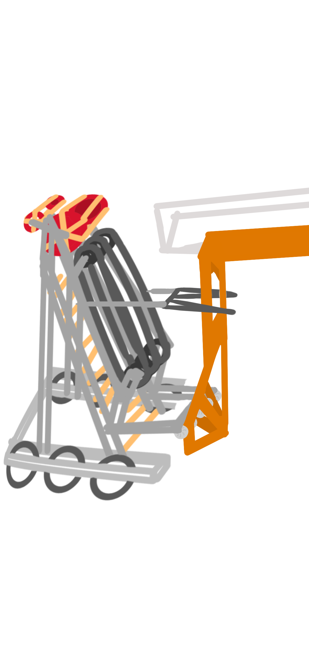

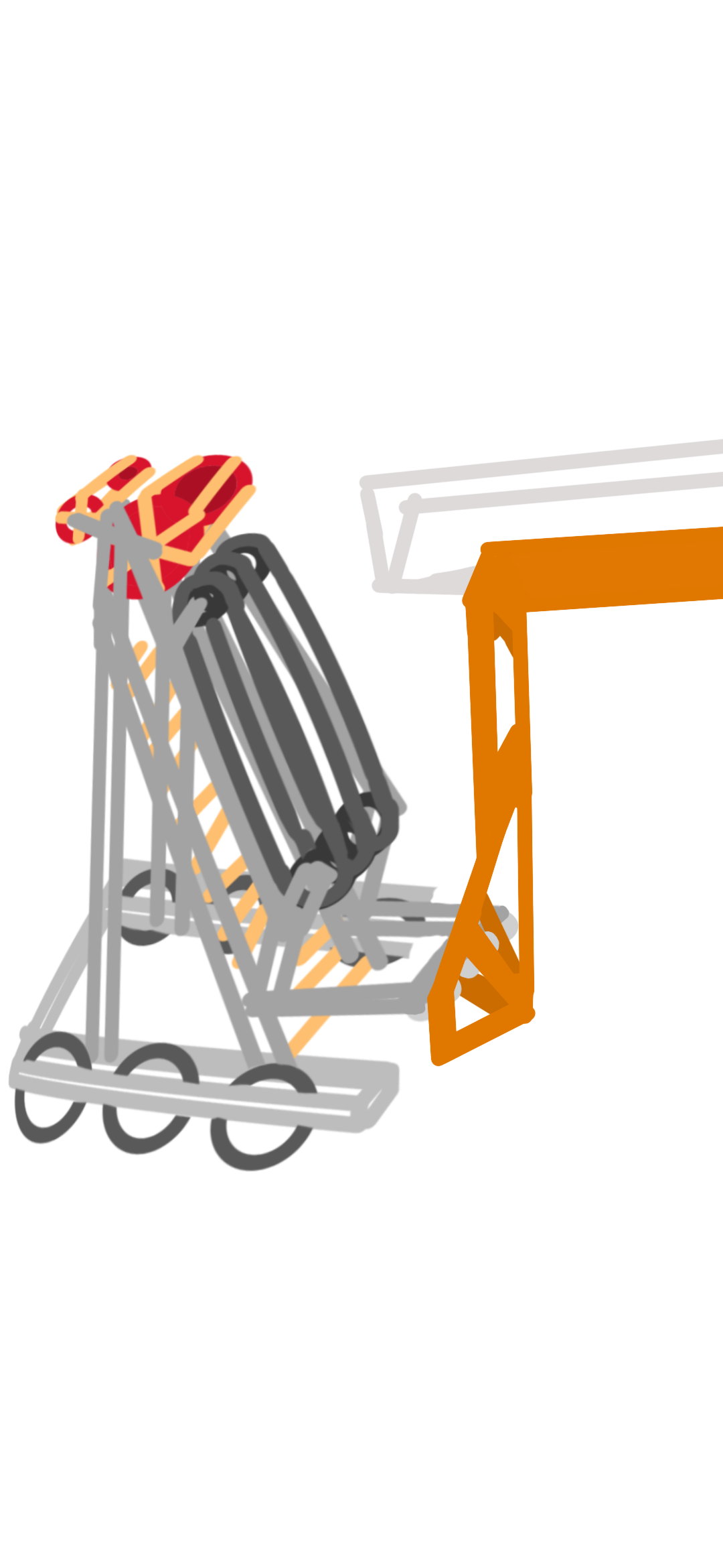

V Shaped Aligner and Triangle Aligner: [Example Image] Do multiple mechanisms of a robot that contribute to a stronger hold on a goal, lead to a violation, even if individually they do not fully constrain the robot?

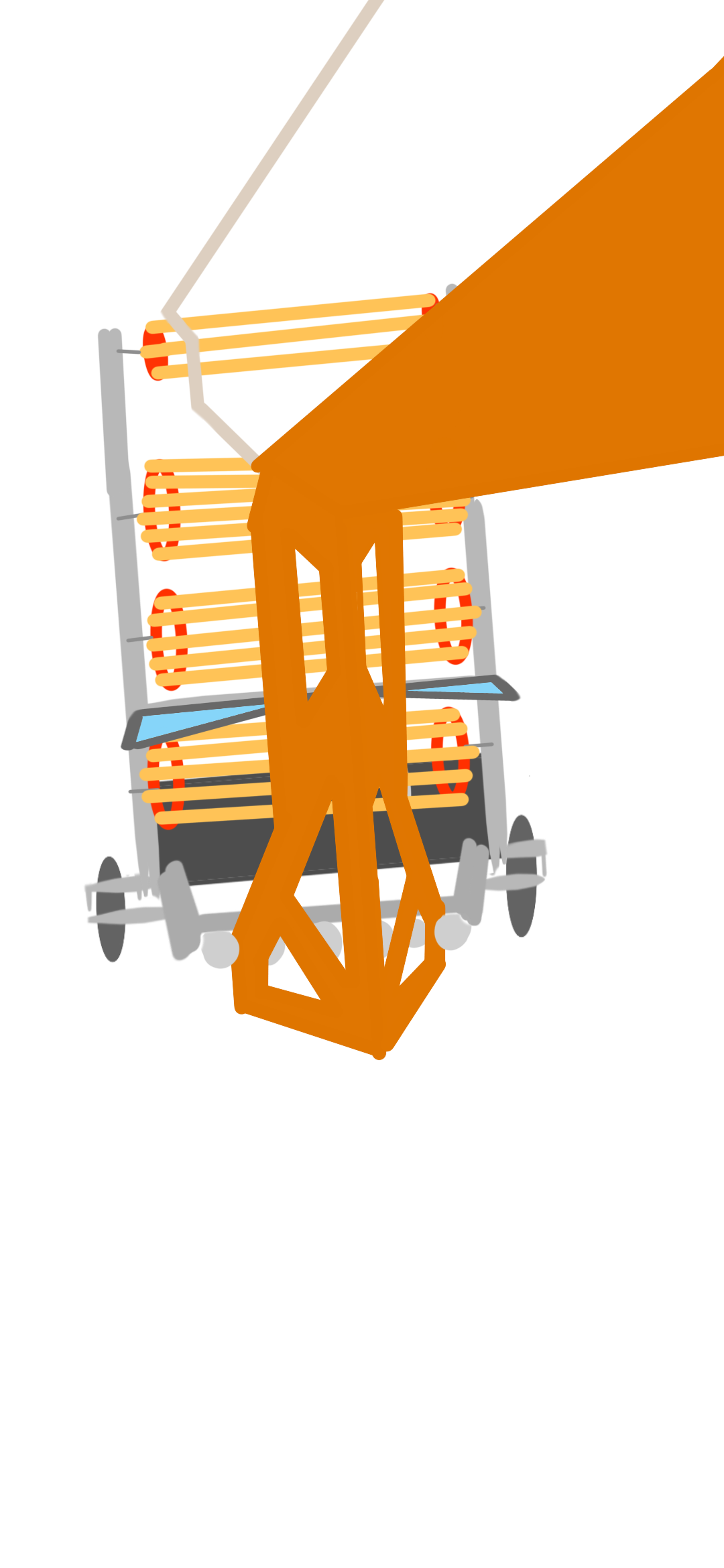

Intake Flex Wheel Interaction: Forwards View: [Example Image]
Flexwheels Friction Holding On the Goal:[Example Image]
Flexwheels On Inside and Outside Edges of a Goal:[Example Image]
If flexwheels friction fit to the inside of the goal tower, is the robot in violation of GG9? What if, instead, the robot has flexwheels on both sides of the goal tower? Is there a difference in ruling based on distance between two flex wheels?

The key words in <GG9> are "grasp, grapple, hook, attach, latch, and clamp."
Some of your examples do that, others don't. Mechanisms that "hug" the goal are more likely to be ruled as <GG9> Violations than mechanisms that go "inside of the V" at the base of the Goal.
It is impossible to issue blanket answers beyond what is written in the game manual that encompass all possible situations based on snapshot descriptions of a hypothetical Robot, mechanism, or action. Final rulings must be made by Head Referees based on the context of the Match.

  1. Multiple Robot mechanisms interacting with a Goal at different heights: This one will vary widely by actual Robot build, and isn't easily categorized. Because the top mechanism in your image is inside the Goal, this specific example may be at risk of a <GG9> violation if the Robot is pushed sideways (see our related ruling in Q&A 2845).
  2. Multiple mechanisms of a Robot contribute to a stronger hold on a Goal: In general, a "stronger hold on a Goal" is likely to be viewed by a Head Referee as hugging or hooking onto that goal and has a very high risk of being called as a <GG9> Violation.
  3. Flex wheels that friction fit inside of the Goal tower: We'd generally consider this as a mechanisms that goes "inside the V" of the Goal with a low risk of being called as a <GG9> Violation.
  4. Flex wheels on both sides of the Goal tower: this is more likely to be viewed as hugging the Goal, and has a very high risk of being called as a <GG9> Violation.
At what angle would an aligner to the goal tower become a GG9 Violation? Is there a change in ruling if there is an offset between the center triangle and the outside v-shape?
We can't answer this one, and each Team will have to choose the level of risk they're willing to take. See #s 2 & 4 above.
