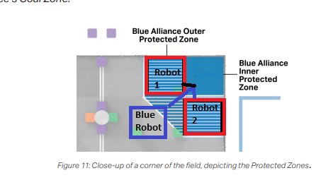

Are robots allowed to park in the outer protection zone with the intention to block opponent robot from entering the inner protection zone?(Assume Case A is not met)
Will robots be in violation of Case D, E if the robots playing defense are being pushed into the inner protection zone/ by the opponents if they leave immediately upon being pushed into the inner zone?
Will robots be in violation of Case D if the robots playing defense are being pushed to contact the barrier/goal zone in the unprotected zone if they leave immediately upon being pushed into the barrier/goal zone?
Will robots be in violation of Case B,F if there are scored cubes in the goal zone, and robots playing defense are being pushed into the inner protection zone and touched/ knocked over a stack if they leave immediately upon being pushed into the inner zone?
Will the two robots playing defense in this scenario receive protection from G12? My interpretation is that since they are partaking in defensive strategy, they will not receive protection for trapping, is this interpretation correct?
There are no rules prohibiting this, thus it is legal.
SG3 does not supersede G14. Therefore, it will be at the Head Referee's discretion whether this contact was solely the result of being pushed by their opponents. If this is the case, then it would not be considered a violation, provided that the defensive Robot makes immediate and visible attempts to leave the Inner Protected Zone.
That being said, it is impossible to provide a blanket answer that would cover all possible hypothetical interactions. G13, which states that offensive Robots receive the "benefit of the doubt", may be used liberally in these judgment calls. Therefore, in contrast with the above, a Head Referee may make the judgment call that G14 is not applicable, and an SG3 violation would result. Some scenarios that could drive this judgment call are as follows (although this is not a comprehensive list):
  • A defensive Robot "baiting" an offensive Robot into causing contact
  • A defensive Robot driving in a manner that causes accidental contact ("A Team is responsible for the actions of its Robot at all times" per G12)
  • A defensive Robot not making an immediate and visible attempt to exit the Inner Protected Zone upon entry
Teams attempting a defensive strategy such as the one included in your attached image should be very cognizant of this possibility, and the risk they are taking in doing so.
We are not entirely sure what you mean by "protection for trapping". To be clear - if you are asking about an offensive Robot attempting to utilize their Goal Zone, if they will receive a Trapping count for confining the defensive Robots, then your interpretation is correct. Per G13, the offensive Robot should receive the "benefit of the doubt" and not receive a Trapping violation.
