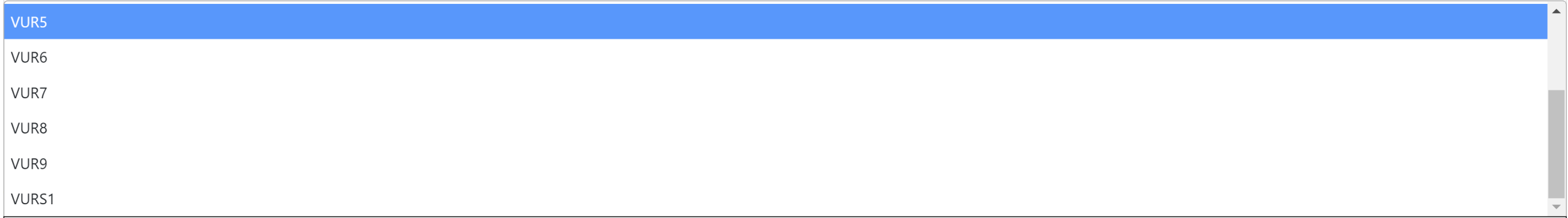

Part 2 The tag section only allows up to VUR9 so I can't tag it correctly with the proper VUR12 tag.
