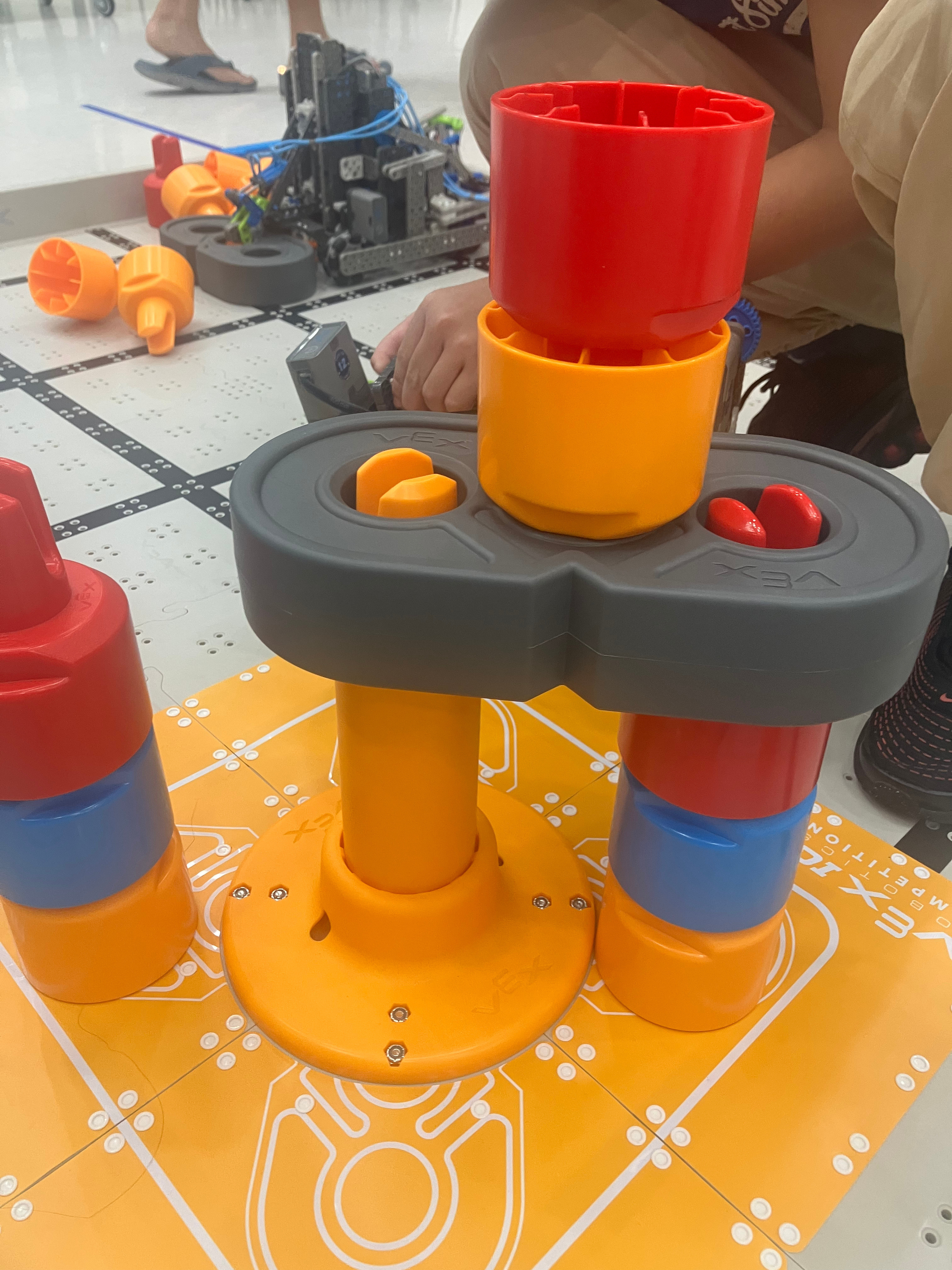

Scenario 1 sees a stack of 3 pins and 1 beam extending off of the floor goal so that the beam connects to the standoff goal, with another stack of 2 on top of connected to the beam. With this would the stack on top of the beam be considered placed on the floor goal because it is connected to the beam, or placed on the standoff goal?

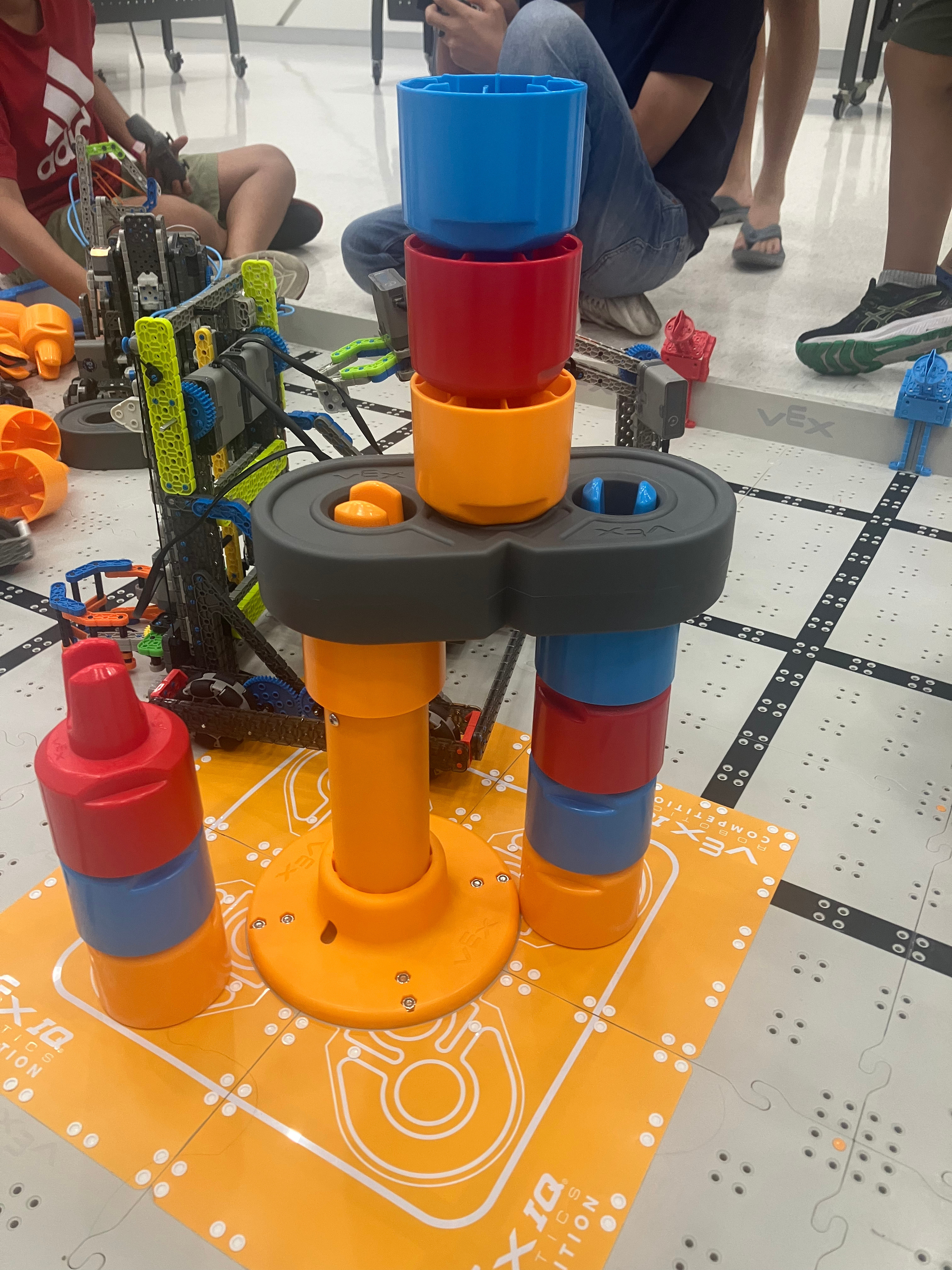

Additionally, Scenario 2 sees the same scenario but now the beam is considered connected to the standoff goal due to an added pin in between the standoff goal and the beam. Would this change the outcome of the Scenario?

Thank you for your questions. Clause c.iv of rule <SC5> will be revised as follows in the next game manual update to clarify how Stacks can qualify as Placed in the Standoff Goal.
The Stack is above the Standoff Goal in one of the following configurations:
  • The Stack is Connected to the Standoff Goal
  • The Stack is Connected up from a Beam that is Connected to the Standoff Goal
  • The Stack is Connected up from a Beam that is part of another Stack that is Connected to the Standoff Goal
Because the rightmost Stack in each of your Scenarios is built "down" from the Beam rather than "up" from the Beam, it is not considered Placed in the Standoff Goal, it is considered Placed in the Floor Goal, and it will count toward the maximum number of four Stacks that can be Placed in the Floor Goal.
As a result, your scenario 1 would be scored as:
  • 8 Connected Pins
  • 1 Connected Beam
  • 3 three-color Stacks
  • 3 Matching Goal bonuses
  • 1 Stack Placed on the Standoff Goal
Your scenario 2 would be scored as:
  • 11 Connected Pins
  • 1 Connected Beam
  • 1 two-color Stack
  • 4 Matching Goal bonuses
  • 2 Stacks Placed on the Standoff Goal
